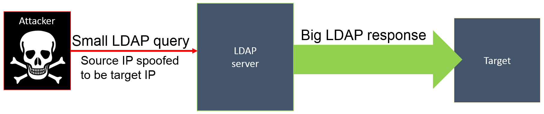

As with any reflection-amplification DDoS attack, three players are involved: the attacker, the unwitting “victim” server, and the attacker’s target. The attacker sends small requests to a publicly available “amplifying” server—in this case, an LDAP server—in order to produce large (amplified) replies, reflected to a target server. The attacker spoofs (changes) the source IP address so that the request appears to have originated from the target, thereby making the LDAP server “reply” to the target. To increase attack efficiency, the attacker usually selects the queries that will yield the largest replies in order to amplify the attack strength.
Figure 1: How an LDAP reflection-amplification attack works

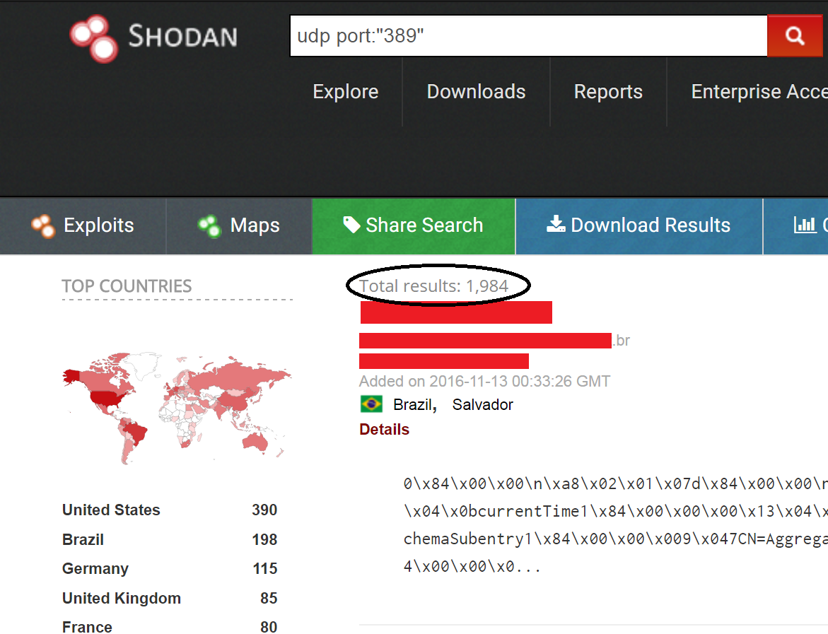

What’s more, it’s simple for just about anyone to use the Shodan search engine to find vulnerable LDAP servers. At the time of this writing, Shodan reported 1,984 vulnerable LDAP servers globally.
Figure 2: Search results for publically vulnerable LDAP servers

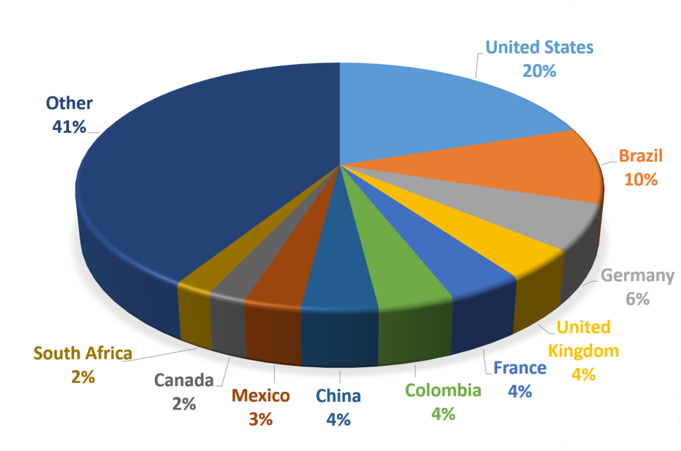

The highest percentage (20 percent) were located in the US, 10 percent in Brazil, and the remaining systems were spread across various countries throughout the globe.
Figure 3: Vulnerable LDAP servers by country

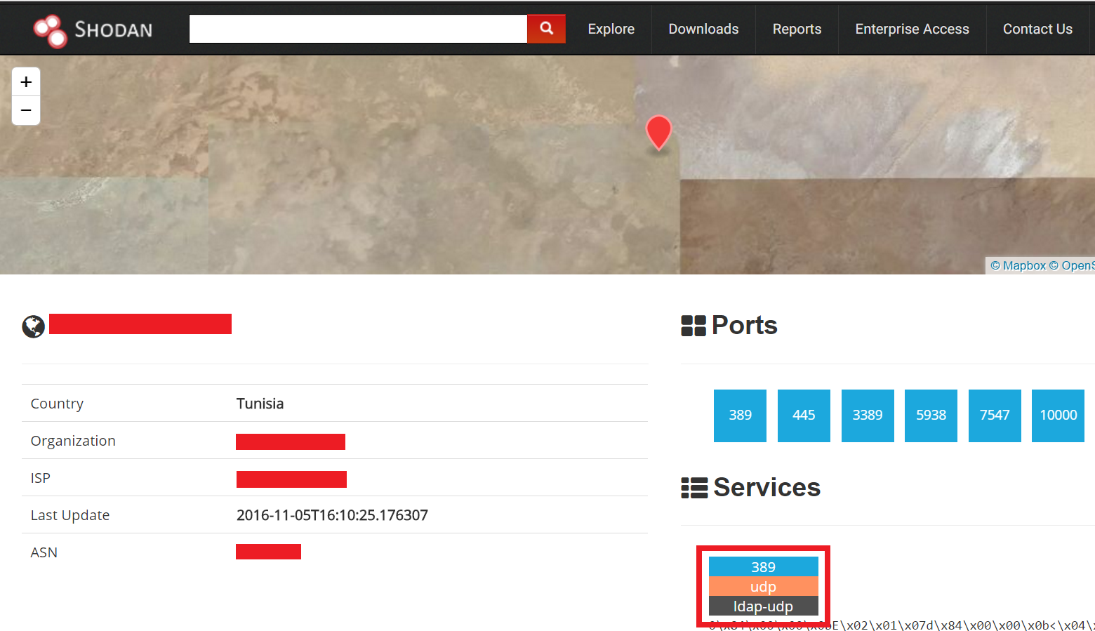

Using the list of vulnerable servers provided by Shodan, we tested a randomly selected server to determine the amplification factor.
Figure 4: Tunisian server tested

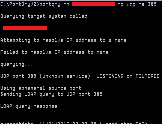

Using Sysinternals’ port scanner PortQry, we generated the LDAP query over UDP.
Figure 5: PortQry scanner generating the LDAP query over UDP

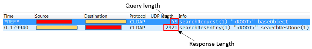

Using Wireshark, we can see the query and response length, shown in Figure 6.
Figure 6: Wireshark displays the query and response lengths
The response length of the Tunisian server we tested was 2,921 bytes. Based on the 59 bytes query size, the amplification factor is 49. Subsequent tests of vulnerable servers in Mexico, Kenya, and Pakistan revealed amplification factors of 51, 42, and 48 respectively. These testing figures indicate that an LDAP amplification attack could be just as strong as a DNS amplification attack.
