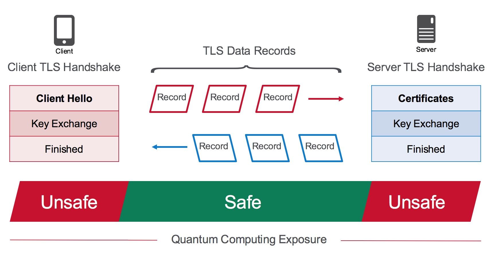

The records are encrypted with a so-called symmetric cipher, typically something easy and fast like the Advanced Encryption Standard (AES) or a stream cipher like AES-GCM, which generates a data stream that can be simply XORed with plaintext to create ciphertext.10 The final portion of the record is a hashed message authentication code (HMAC), which is a fancy term for a checksum. The receiver can use the HMAC to determine that the record hasn’t been tampered with or corrupted. The algorithm for the HMAC is typically a variant of SHA with a specific hash key size of 128 or 256 bits. Processing records—encrypting or decrypting them—is actually so easy that you’ll hear it casually referred to as “record processing” or “bulk encryption.”
So, TLS involves two chains of symmetrically encrypted records going back and forth between a client (browser) and a server (web server or application delivery controller). However, before the client and server can start sending these records back and forth in transit, they need to agree on a fast encryption key used to encrypt all the records. They do this by using one of the nifty asymmetric key exchange algorithms mentioned earlier. Because these agreements, called key exchanges, use asymmetric algorithms such as RSA, ECDSA, ECDH, or DH, they are vastly more computationally expensive than the actual record processing itself.
At a high level, then, TLS is just this easy:
Agree on a session key by using an asymmetric key exchange in a TLS handshake

Before we look at that, let’s start with the good news, which is that record processing in a quantum computing world will be exactly the same. That’s because the symmetric encryption ciphers (like AES) and HMAC hashing algorithms (like SHA) are thought to be mostly resistant to quantum computing, requiring only a doubling of key size to be resistant until the end of time. According to the NSA’s Information Assurance Directorate, “The AES-256 and SHA-384 algorithms are symmetric, and believed to be safe from attack by a large quantum computer.”11
F5 Labs’ own research (/content/f5-labs/en/labs/articles/threat-intelligence/the-2016-tls-telemetry-report-24674.html) shows that 75% of TLS hosts on the Internet already prefer AES-256, so we’re practically there already—at least for the record processing!
Figure 1. Quantum computing exposure, TLS 1.2 Protocol

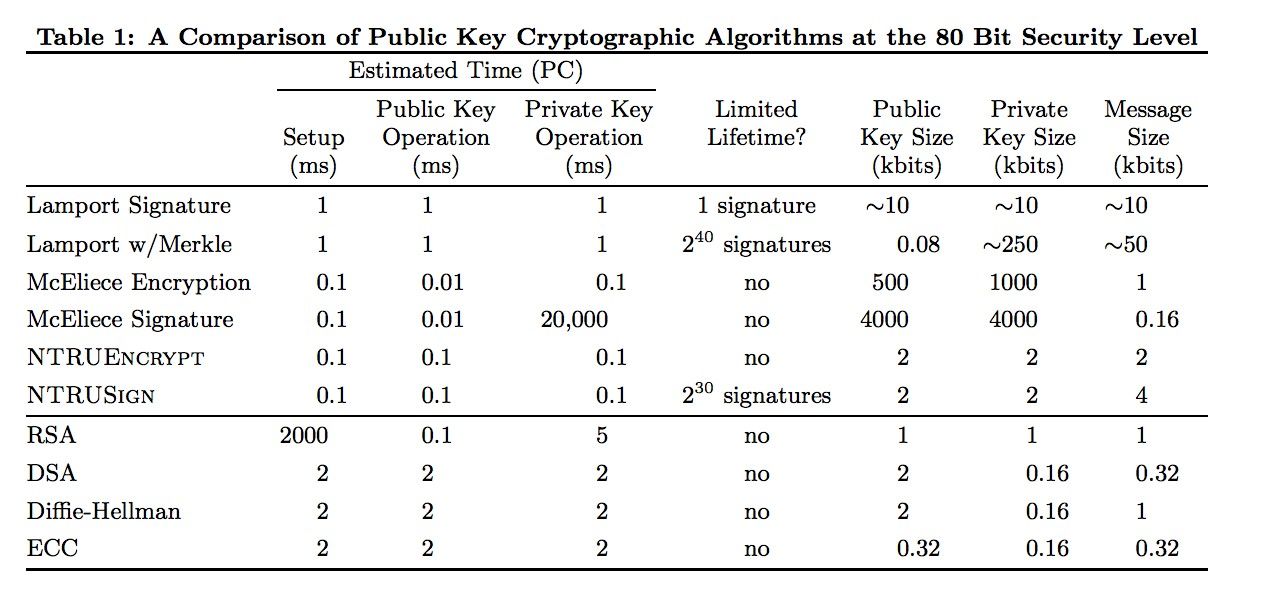

In 2009 two NIST researchers, Ray A. Perlner and David A. Cooper, published a white paper examining the (then) likely post-quantum algorithm candidates. They included the chart below showing some of the algorithms’ comparative metrics against non-post-quantum algorithms (RSA, DSA, DH, ECC).
Since that paper was published, new algorithms have found currency in the community. However, the process of choosing one is a little like auditioning actors for the lead role in Hamlet. You quickly find that none are perfect and, in fact, some suffer from facial warts!
