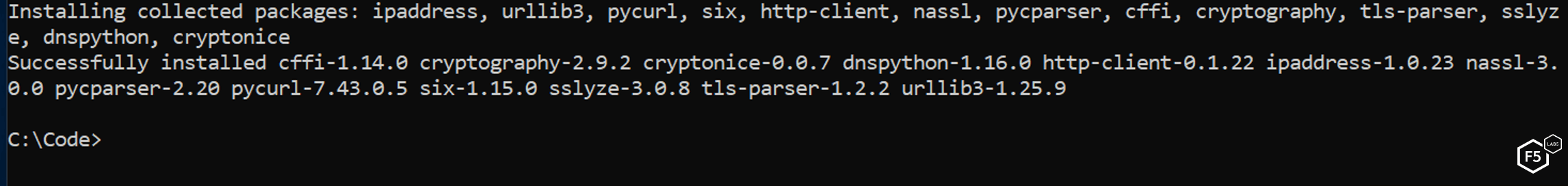

At this point pip installs Cryptonice along with all necessary third-party libraries. If all goes well, you should see something similar to Figure 2:
Figure 2. A successfully completed installation of Cryptonice via pip

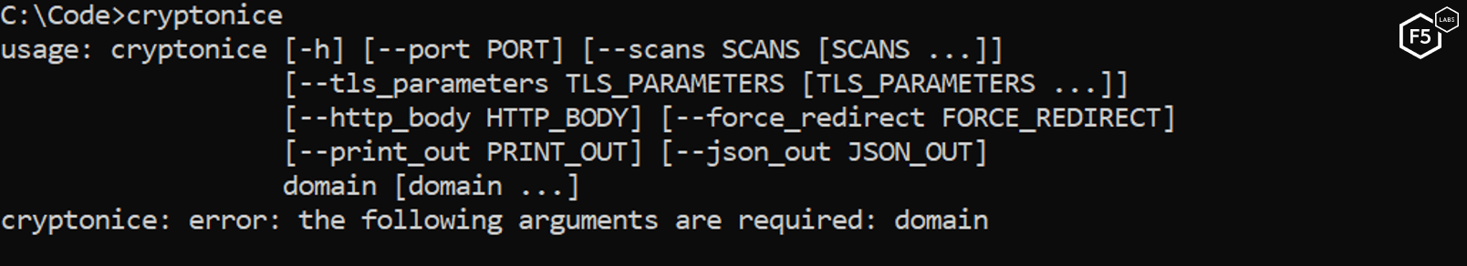

If you run Cryptonice without any arguments, you will be able to see the list of all possible parameters, as shown in Figure 3.
Figure 3. Running Cryptonice with no parameters displays the available options

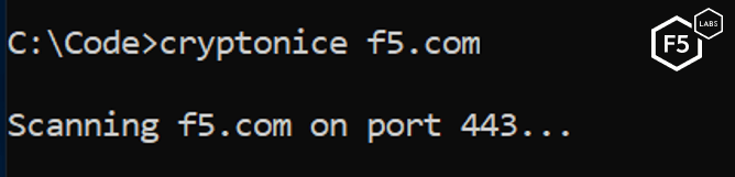

Basic use of Cryptonice couldn’t be easier. Simply type the command and then a destination website that you wish to scan, as show in Figure 4:
Figure 4. Performing a basic Cryptonice scan against f5.com using default parameters

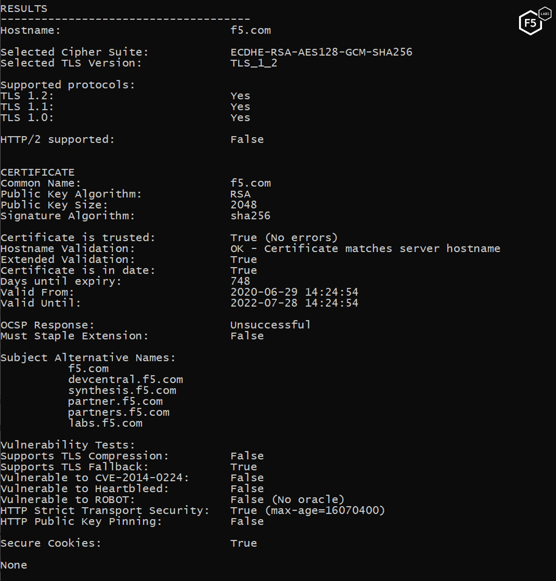

Using the tool at the command line displays an overview of the results in the console. This output shows basic protocol and cipher support, information about HTTP redirects and some information about the DNS records and certificate information, as shown in Figure 5:
Figure 5. Viewing the Cryptonice scan results for f5.com

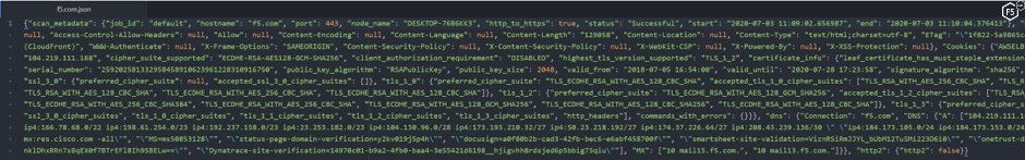

In addition to the console output, the full report is saved to a JSON file. This JSON output, as shown in Figure 6, is far more detailed than the command-line results so it is useful to examine it carefully. The JSON file is compliant with RFCs 8259, 7159 and 4627 as well as the ECMA-404 standard. Output is single-line and optimised for further scripting or automation so human readability is difficult.
Figure 6. Viewing the JSON output of a Cryptonice scan

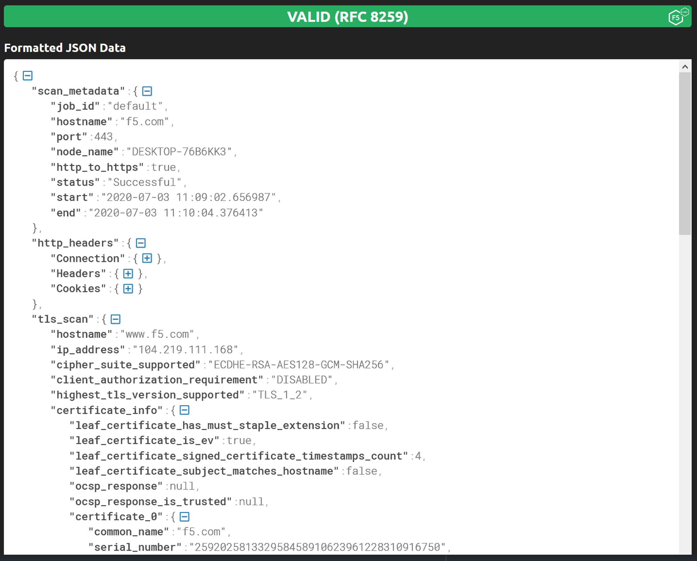

For human readability we recommend the use of a JSON formatter which displays indented JSON over multiple lines, as shown in Figure 7.
Figure 7. Viewing same output as seen in Figure 6 using a JSON formatter (Source: https://jsonformatter.curiousconcept.com)

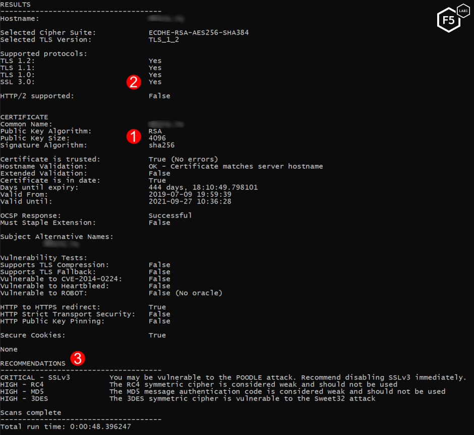

The first example in Figure 8 shows a number of security concerns with this website. The site is using a long 4096-bit RSA key with their certificate (1), which is great! However, the list of protocols also shows that SSL v3 is supported which presents a serious weakness to this site (2). In the Recommendations section Cryptonice shows a CRITICAL warning for SSLv3 and shows additional High warnings for the use of weak ciphers (3). The full list of ciphers this site supports is visible in the JSON output for this scan.

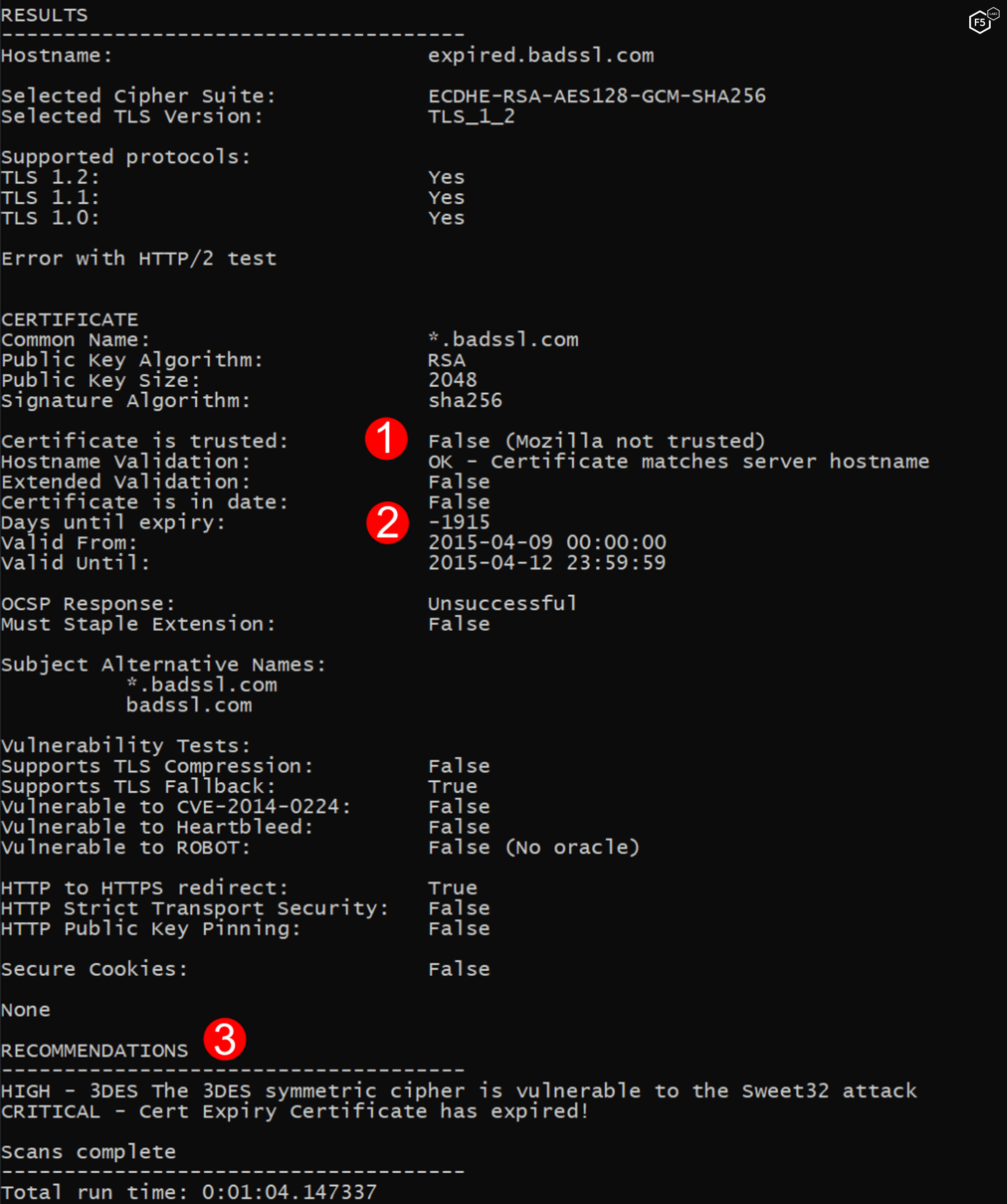

Figure 9 shows the results of a scan against a site with an expired certificate. This is represented in a number of places in the Results and Recommendations sections. The entire certificate chain is tested for errors and, in this case, shows False (1). We can also see a negative number of days left for this certificate, indicating that the certificate ‘Valid Until’ date has passed (2). Finally, we see a CRITICAL warning, making it clear to us that this certificate has expired (3).
Figure 9. Using Cryptonice to detect expiring certificates
