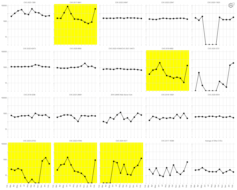

Figure 1 shows February traffic for the top ten CVEs that we track. As we described earlier, CVE-2017-9841 dominates activity for the month. See the next section “Targeting Trends” for an easier to understand view using a logarithmic scale in Figure 3.

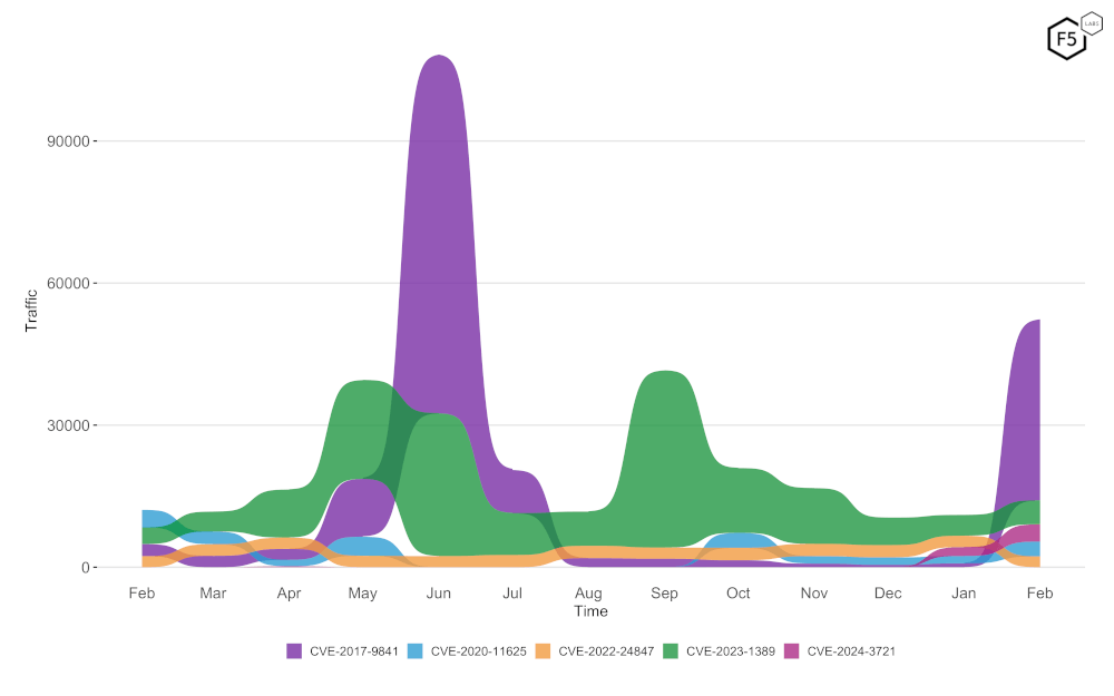

Figure 2 is a bump plot showing the change in traffic volume and position over the last twelve months. We can see that while CVE-2017-9841 has seen pronounced activity this month, June’s spike in activity was even more pronounced. Growth continued for CVE-2024-3721, as well as for CVE-2020-11625. CVE-2023-1389 has seen significant variation looking back to fall through summer of 2024, but saw no significant change in activity in recent months.
Figure 2. Evolution of vulnerability targeting in the last twelve months. Pronounced activity in CVE-2017-9841 that is still dwarfed by the June 2024 spike.

Figure 3 shows traffic for the top 20 CVEs by all-time traffic, followed by a monthly average of the remaining CVEs.
Several CVEs had significant upticks in volume this month, of which CVE-2017-9841 is the most notable. CVE-2019-9082 has broken from its otherwise downward trend, CVE-2022-47945 has seen revived interest, and CVE-2024-4577 has continued its upward trend. The biggest falloff in volume was by CVE-2023-23752. Time will tell if this falloff is the beginning of a downward trend here.

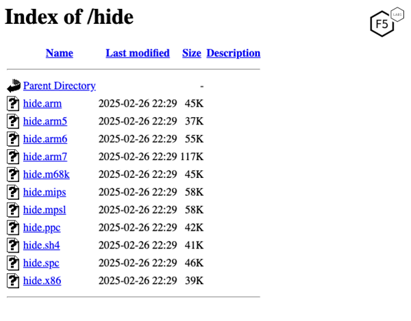

By loading the url hxxp://154.18.239.232/hide/ we were able to get a directory listing which included several versions of the malware we had observed being fetched.
The files were all timestamped 2025-02-26 22:29.
