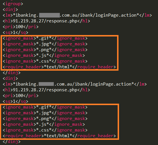

In the following illustrations, one can see the fields that were added. These are intended to filter out certain file types as they can be fetched from the real bank site.
Figure 2: TrickBot’s old configuration
Figure 3: TrickBot's new configuration

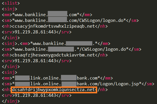

Static injections, also known as “redirects,” are now fully functional in TrickBot. When the user tries to connect to a targeted site, the malware redirects the request to a malicious C&C server and returns a fake page that looks exactly like the bank’s original page.
Figure 4: TrickBot's new configuration

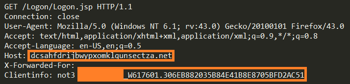

Inside the browser function hook, the request page is forwarded to the fake domain containing Bot ID inside the “ClientInfo” header.
Figure 5: A redirected request to a malicious domain

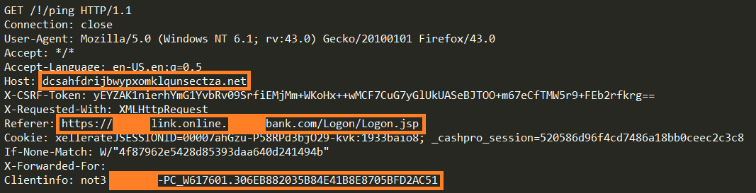

A ping request, which is sent from every page in the site, is launched by a “start_ping” function on a “document.ready” event in an endless loop every two seconds (like Dyre).
These requests are also redirected to the malware’s server inside the browser network hook.
Figure 6: A ping is sent by the malicious code in the page

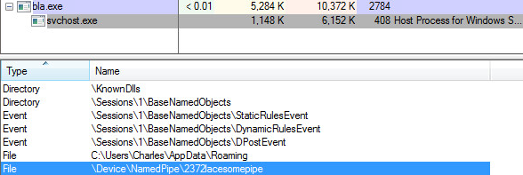

The browser module waits for incoming pipe connections. The main module connects to the browser module using a named pipe “\Device\NamedPipe\ <PID >lacesomepipe” where PID is the process ID number of the browser.
Figure 8: The pipe in the infected svchost.exe process

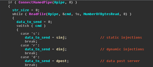

The commands are one byte long. Each command is a letter that signifies the data to transfer.
Figure 9: Handling pipe commands
Additional commands include:
“i” – get client_id, e.g.: ADMIN-PC_W617601.A9B4C7FF18D0126F481CA1758B0A0FEF
“a” – get self ip, e.g.: 8.8.8.8
“g” – get group_id, e.g.: lindoc3
“q” – quit and disconnect the pipe
The browser module asks the main module for every one of these data pieces and if one of the data pieces is not received, the malcious thread will terminate and the browser will not be patched by the malware.
A security improvement from Dyre’s pipe is implemented by closing the pipe right after all the commands are sent. Meaning that if a researcher is inspecting the malware, connecting to the pipe in order to get the configuration is not as trivial as it was in Dyre.
