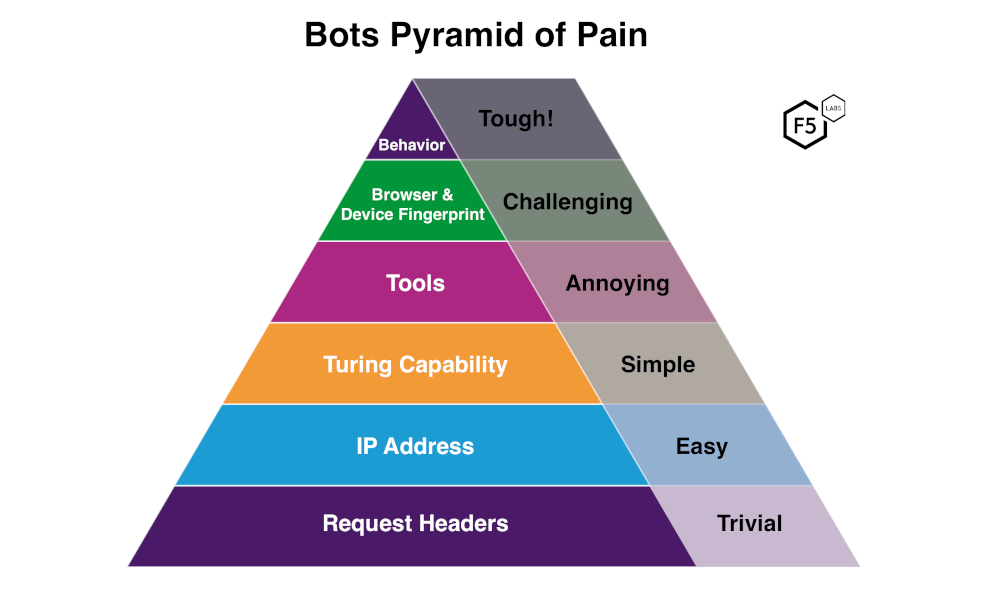

Bots Pyramid of Pain
The pyramid in this framework consists of a number of layers, see Image 1. Each layer has a description along with the level of pain it inflicts the bot operator. The bottom later causes the bot operators the least pain, and the top layer the most.
A Pyramid of Pain for defending websites and APIs against automated bots.
Figure 1: A Pyramid of Pain for defending websites and APIs against automated bots.
Blocking Based on Request Headers
At this lowest layer in the pyramid, we start by blocking requests based on the HTTP headers present (or absent) and their values. The most straight-forward of which being the User Agent header. This inflicts a trivial level of pain as bot operators need only provide plausibly valid headers and they are trivial to fake. Modifying or adding a header is a literal one-line code change for bot operators.
Blocking Based on IP Address
At this layer connections are blocked or rate-limit based on the IP address and/or any of its associated metadata (such as IP reputation, ASN, country, or geolocation). This poses no real challenge to bot operators. They can easily either “go low and slow” (i.e. send only a few requests per IP address per hour/day), or they can utilize a proxy network .
Blocking Based on Turing Capability
At this layer bots are explicitly challenged to prove they can solve puzzles only a human can solve (often referred to as CAPTCHAs). That’s the theory at least. In practice this mostly inflicts pain on actual humans. Bot operators will leverage either freely available software solutions or crime-as-a-service offerings to solve the puzzles. While this is operationally a simple level of pain to inflict, it does require the bot maintainer to have a basic level of resourcefulness and awareness of the crime ecosystem.
Block Based on Tools
At this layer, defenses attempt to detect the tooling, for example, Browser Automation Studio. If it’s possible to detect and block the use of that tool, bot operators are forced to reimplement their scraper using other tooling. The more tooling that can detected and blocked, the more the bot operators are forced to spend time and effort on specialized tooling.
Block Based on Browser & Device Fingerprint
At this layer the browser or client device is interrogated. On the assumption that sophisticated fingerprinting techniques are available, this inflicts challenging levels of pain. The key aspect of this pain is that while a bot maintainer can conceivably pass a single fingerprint check they need to do so in aggregate for large volumes of requests. While digital fingerprints can be purchased, generating 100s and 1000s of internally consistent fingerprints sufficient to blend in with legitimate user fingerprints is no small feat.
Block Based on Behavior
Defenses at this layer are the most complex to implement, prohibitively so if this solution is being developed in-house. At this layer bots must be identified and blocked based on their behavioral patterns. This is the maximum pain that can be inflicted as it gets to the heart of the bot operators' objective. Forcing a bot maintainer to imitate legitimate user behavior is a very heavy tax indeed.
