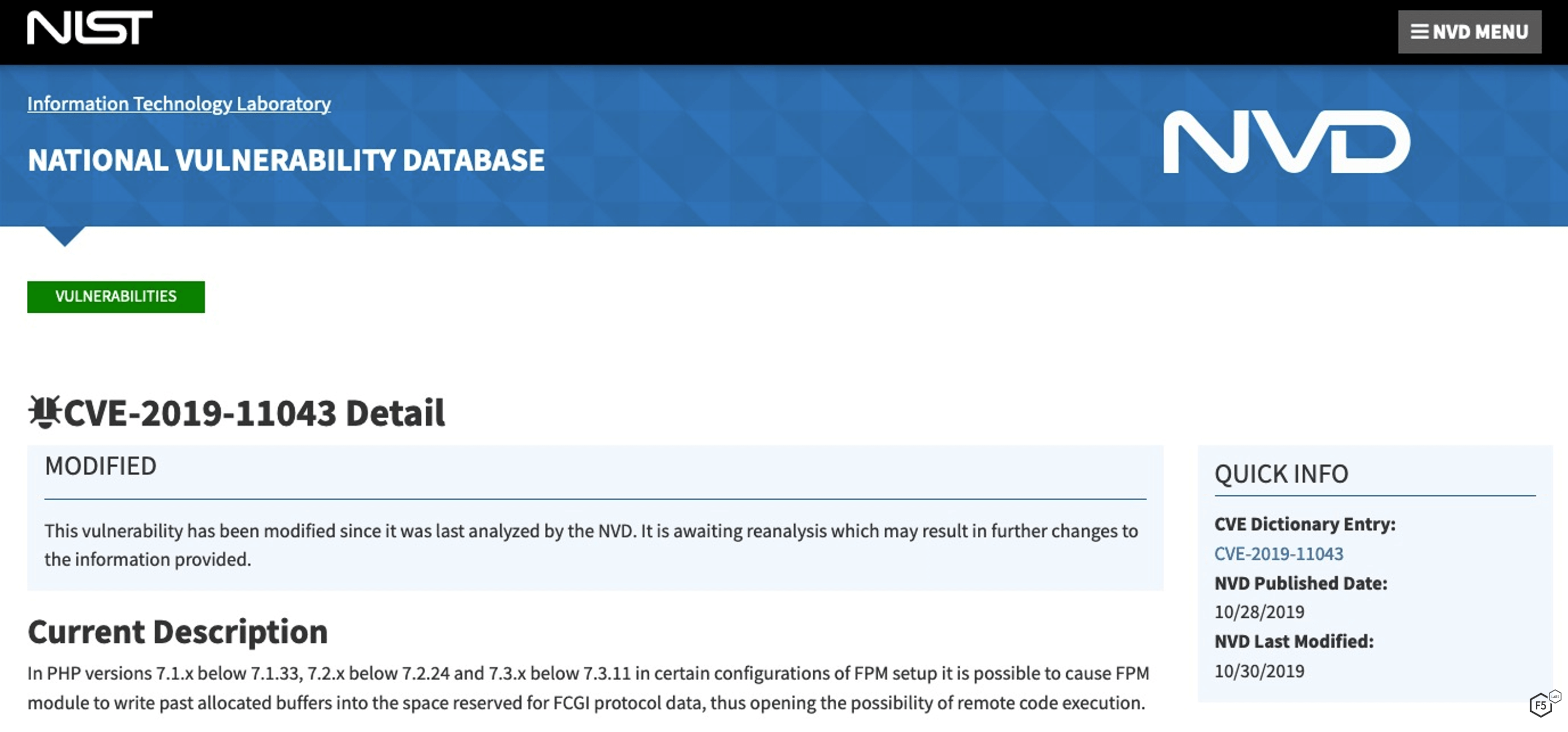

Let’s work through an example here with an eye towards how to measure each of these factors and perform the calculation. From 2019, we can look at CVE-2019-11043, a vulnerability in the web programming language PHP. Pulling up the National Vulnerability Database (NVD) entry for this at https://nvd.nist.gov/vuln/detail/CVE-2019-11043, we can get some basic information on the vulnerability as shown in Figure 1.
Figure 1. Description of CVE-2019-11043 at National Vulnerability Database site.
Right off the bat, PHP is a web service, so we can see that we can tick off one of the factors: "Does this vulnerability impact web service.” So that’s the first weight of 0.06.

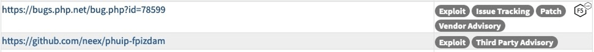

Within those references, there are links to published exploits, as shown in Figure 3.
Figure 3. Exploit links for CVE-2019-11043 at National Vulnerability Database site.

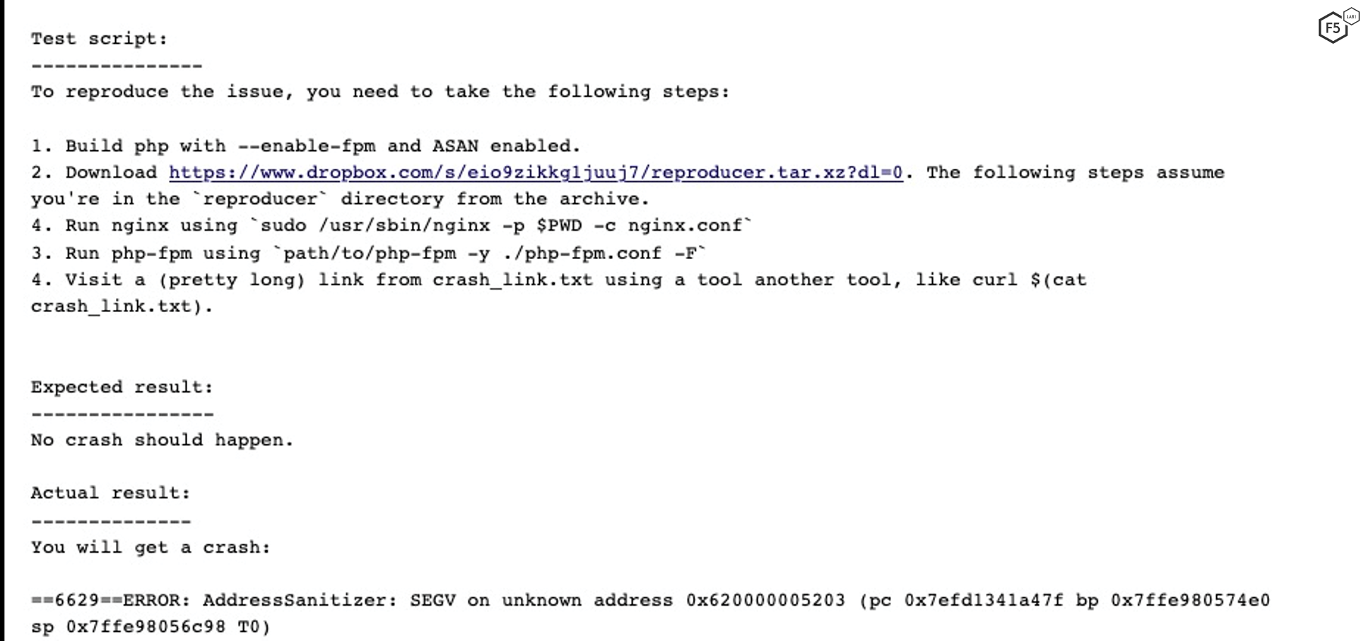

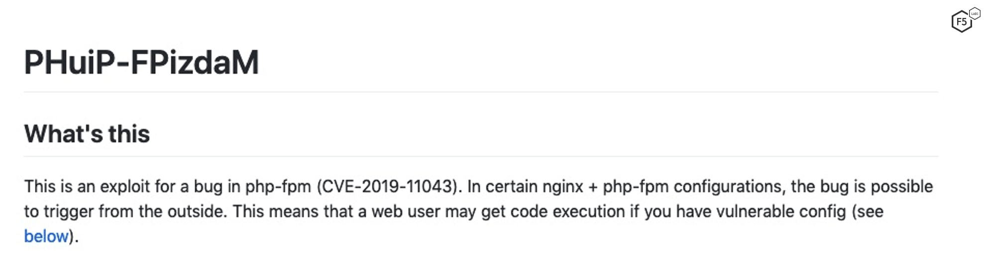

Clicking on these links provides good vulnerability exploit information, as shown in Figures 4 and 5.
Figure 4. Exploit detail for CVE-2019-11043 from https://github.com/neex/phuip-fpizdam.
Figure 5. Exploit detail for CVE-2019-11043 from https://bugs.php.net/bug.php?id=78599.
The exploit descriptions provide more information for the other key factors. First, because there are exploits, we know factor “Proof-of-concept exploit available” is yes, adding a weight of 1.50. The first impact of the exploit shows that code execution is part of the payload, so “Enables arbitrary code execution” is a factor with a weight of 0.57. Continuing to read the second entry, we can see this can cause denial of service (“you will get a crash”), so another factor weight of 0.22. Lastly, the reproduction section shows that this works over the network, so add “Exploitable via remote access” with a weight of 0.23.

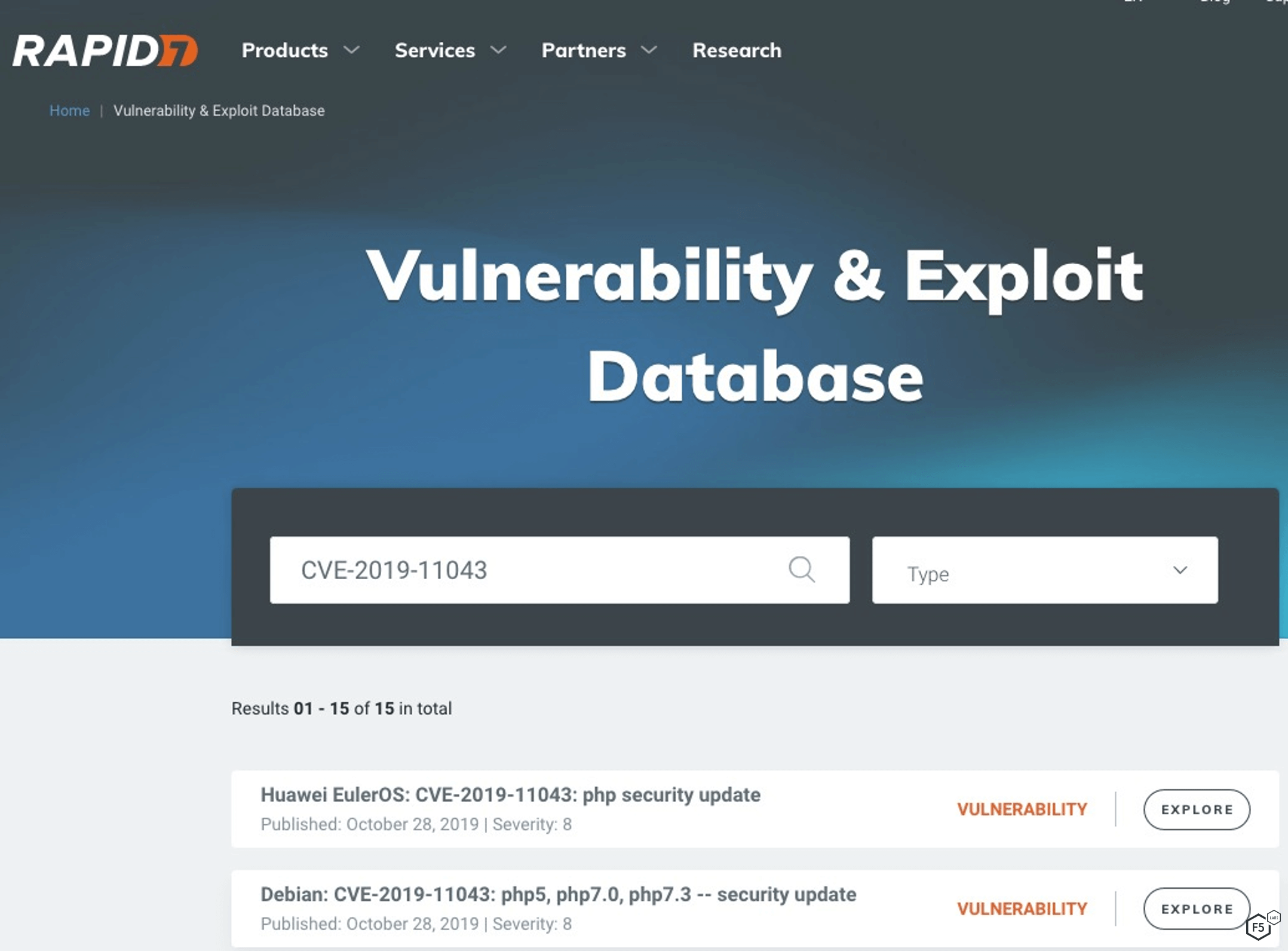

Even though there is a proof-of-concept exploit, we need to find out if this exploit has been weaponized. Per this model, weaponized exploits appear in “Rapid 7’s Metasploit framework, D2 Security’s Elliot Web Exploitation Framework, and the Canvas Exploitation Framework.” A quick check on the Rapid7 website shows 15 entries for CVE-2019-11043, as shown in Figure 6. This means we add a weight of 2.00.
Figure 6. Rapid7 Weaponized Exploits for CVE-2019-11043 from https://www.rapid7.com/db/?q=CVE-2019-11043&q=CVE-2019-11043.

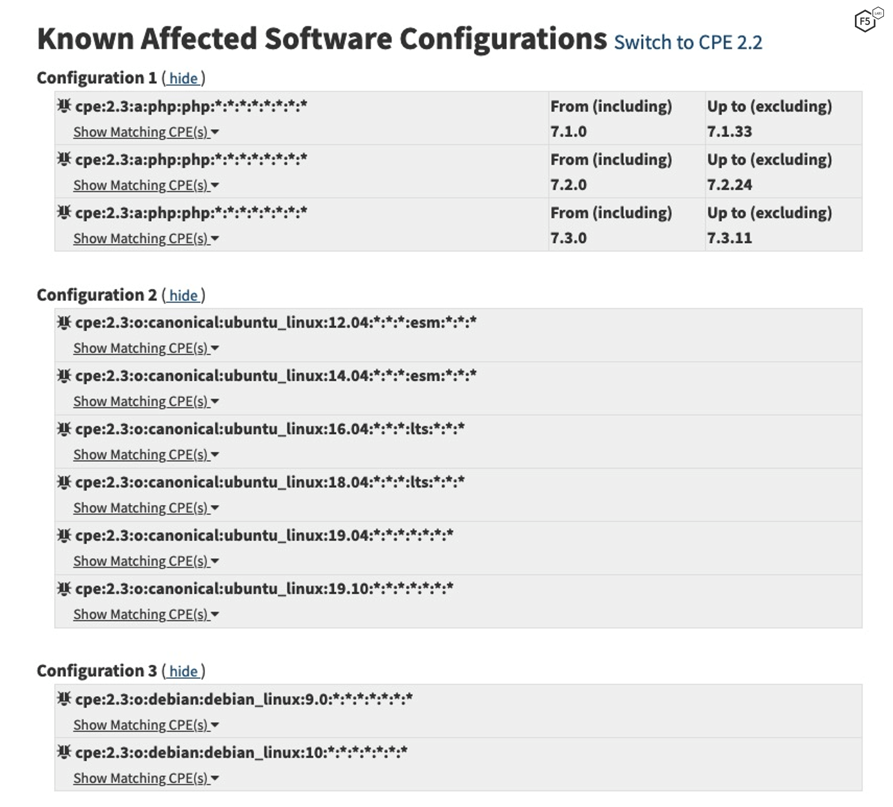

Now that we’ve learned what we can about the exploits, we can return to the NVD page. After the references, there is a list of affected software (a snippet is shown in Figure 7), which is another major factor.
Figure 7. Affected software for CVE-2019-11043 at National Vulnerability Database site.
In this list, we don’t see any of the significant factored software types, so there are no weights to add here.
