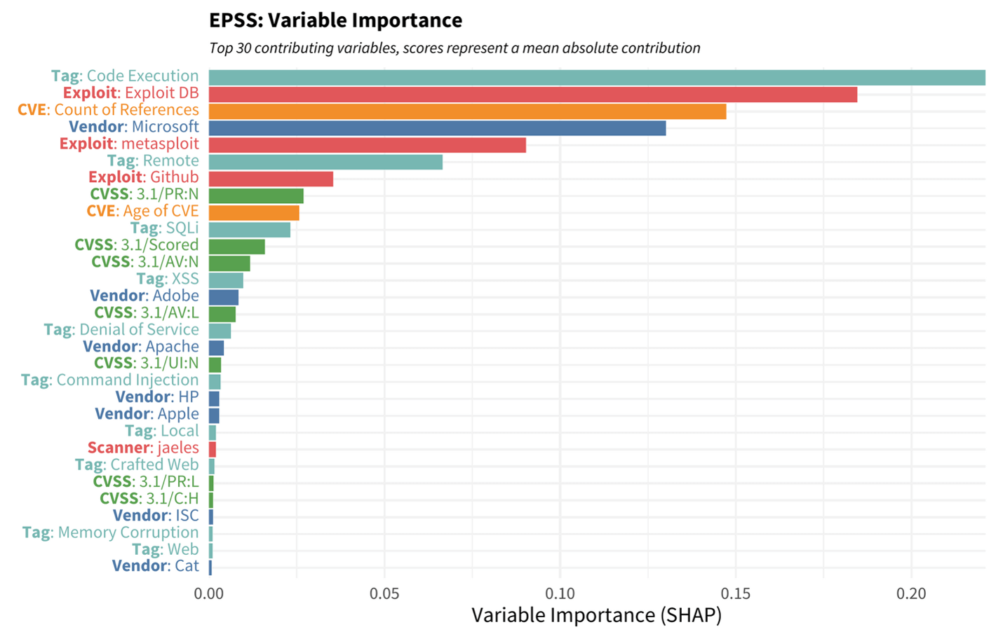

At their most abstract, all machine learning systems require two kinds of inputs: training inputs and runtime inputs. The training inputs are used to determine optimum parameter weights for the model, and the runtime inputs are what the model then processes to produce its output. For EPSS the runtime inputs are a collection of roughly 1,500 vulnerability characteristics that are collected and updated daily. These are variables such as the existence of publicly available exploit code, the vendor of the affected system, and the technical impact of the vulnerability (such as remote code execution or directory traversal). Over the course of training the model will determine the relative importance of each of these variables to each vulnerability.

Figure 1. EPSS parameter importance as calculated by Shapley Additive Explanations (SHAP). Higher values indicate a parameter that has a greater effect (positive or negative) on the exploitation outcome. Note that in this model parameter weights vary by CVE. Image credit FIRST https://www.first.org/epss/model
The first design of EPSS used logistic regression, but subsequent models (v2022.01.01 and v2023.03.07) have used Boosted Gradient decision trees (XGBoost). This is an ensemble model, which means that it creates many different decision trees with slight variations and takes an aggregate output from all of them. In the case of XGBoost, the model progressively adds only those trees that are helpful to the model, until further additions fail to improve its predictive capacity.6

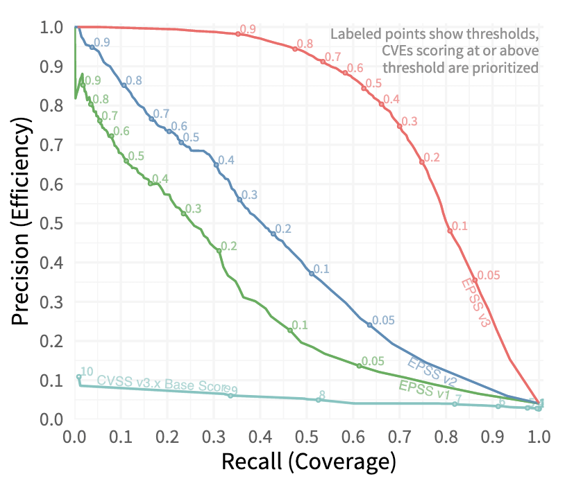

The subsequent generations of EPSS using XGBoost perform significantly better than the first version using logistic regression, but in order to really understand the performance gains, we need to first understand how errors manifest in a system like this.7 To evaluate the predictions against subsequent exploitation observations, we need to choose a score threshold above which we would patch. The threshold (e.g. patching all CVEs with an EPSS score of 0.5 or higher) would in turn allow us to identify two kinds of errors: false positives and false negatives.
In the context of exploit prediction, a false positive at any given score threshold would be a vulnerability whose EPSS score exceeded the threshold and was therefore patched, but was in fact not exploited in the 30-day timeframe. Patching this vulnerability would represent poor prioritization and a “premature remediation.” A false negative would be a vulnerability that was not patched because its EPSS score was below the given threshold, but was actually exploited. Not patching this vulnerability would constitute additional risk to the organization.
With the understanding that each EPSS patching threshold will produce different rates of false positives and false negatives when compared with true exploitation activity, it is possible to plot these error rates for all thresholds in a Recall/Precision plot (Figure 2). Recall (also termed Coverage in this case) is the proportion of exploited vulnerabilities that were patched at a given threshold. This can be thought of as a measurement of how much “true” risk was mitigated. Precision (also termed Efficiency here) is the proportion of patched vulnerabilities that were actually exploited. This can be thought of a measure of how much work was on mistakenly prioritized risks that did not materialize. This kind of analysis allows us to visualize the tradeoffs of different thresholds (and therefore different mitigation strategies) across the different generations of models.
Figure 2. Recall-precision graph for EPSS and CVSSv3. This plot shows the tradeoffs in coverage (% of exploited vulnerabilities remediated) and precision (% of remediated vulnerabilities exploited) for different thresholds and management strategies. Note that all three EPSS versions shown here dramatically outperform CVSS as a triage tool. Image credit https://arxiv.org/pdf/2302.14172.pdf.
For instance, an extreme strategy intended to minimize false negatives by patching every single exploited vulnerability (100% Recall/Coverage) would only have an Precision/Efficiency of ~4%, even for the latest v3 model. In other words, this strategy would catch all of the exploited vulnerabilities, but 96% of the patched vulns would be mis-prioritized and prematurely remediated. At the other extreme, a strategy intended to minimize false negatives by mitigating only exploited vulnerabilities (100% Efficiency/Precision) would have a coverage of only 2% or so, meaning that 98% of exploited vulnerabilities would go unpatched.
The progressively greater areas under the curves for EPSSv2 and particularly v3 indicate that they outperform their predecessors at all levels of effort or thresholds of risk, and dramatically outperform CVSSv3. The convexity of the curve for v3 is particularly notable since it means the tradeoffs are much smaller—note that the Efficiency/Precision does not begin to suffer significantly until Recall/Coverage goes past 50% (at a threshold of roughly 0.75), indicating that using v3 thresholds for action would result in significantly better prioritization than v2 at any risk appetite.
