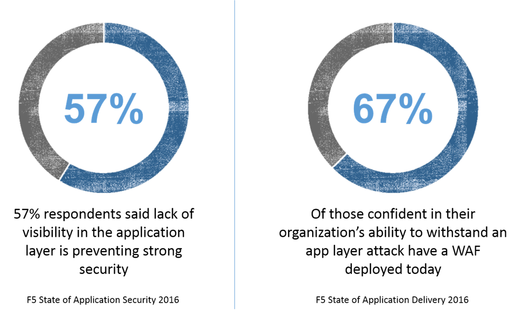

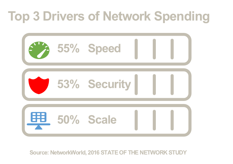

The problem is that real-time, actionable visibility – especially at the application layer where it’s increasingly critical – is often elusive to achieve. Even though we know it’s important to security efforts. To wit, in our State of Application Security 2016, the majority (57%) of respondents said a lack of visibility in the application layer is preventing strong security. That’s often because performance is impacted when security needs to climb up the OSI stack to the top, and improving application performance remains a top driver of networking investments. Ahead of security. These are not unreasonable objections, either.
