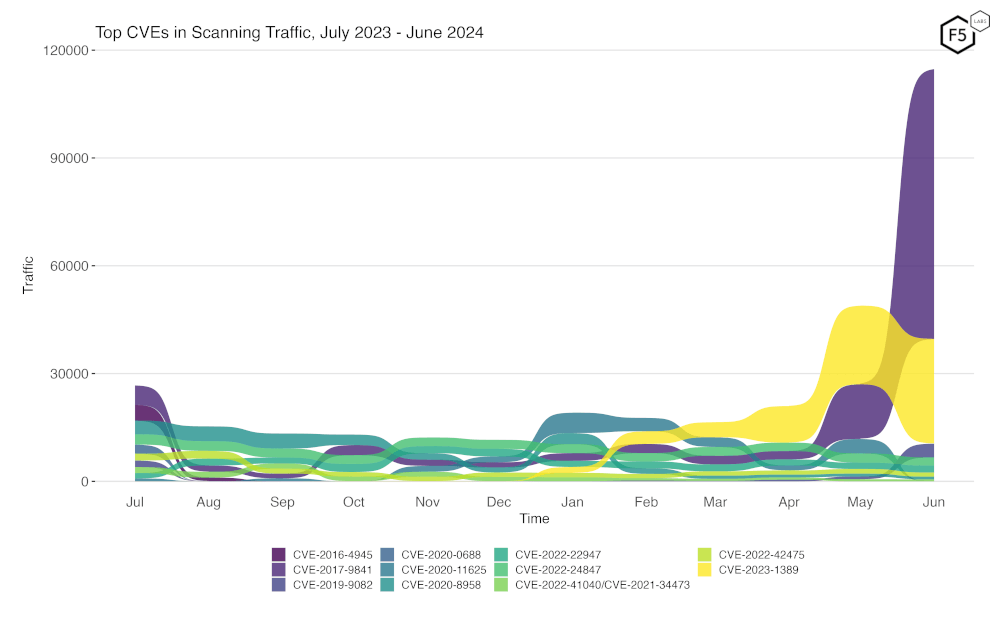

Figure 2 is a bump plot showing the change in traffic volume and position over the last twelve months. This shows very clearly the massive increase in scanning for CVE-2017-9841. Also notable is the continued increase in scanning for CVE-2023-1389, with its total volume (seen in the width of the colored area) indicating that more scanning for this occurred last month than at any time in the previous eleven months.
Figure 2. Evolution of vulnerability targeting in the last twelve months. Note the huge increase in scanning for CVE-2017-9841.

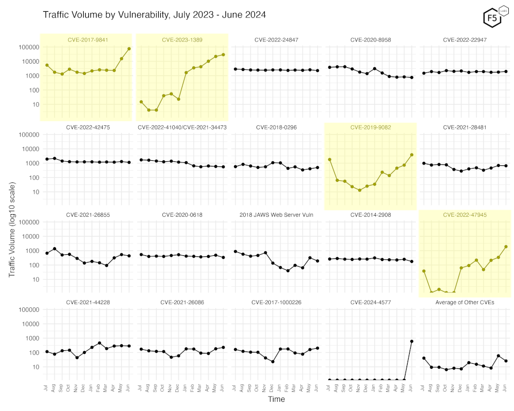

Figure 3 shows traffic for the top 19 CVEs by all-time traffic, followed by a monthly average of the remaining CVEs. This once again shows the dramatic increase in CVE-2017-9841, as well as the movement of CVE-2023-1389, along with modest increases in CVE-2019-9082, and CVE-2022-47945.
Figure 3. Traffic volume by vulnerability. This view accentuates the recent changes in both CVE-2023-1389 and CVE-2017-9841.
