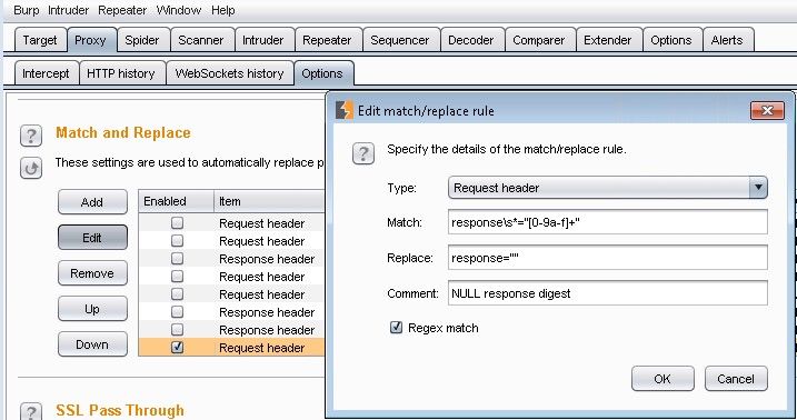

While Intel didn’t come out and tell everyone exactly what the problem was, the guys at Tenable figured it out within minutes,2 and even show how simple it would be to exploit via Burp Suite. They’ve updated Nessus3 to scan for it, and everyone is broadly recommending that we all disable ports 16992, 16993, and 623 for good measure.

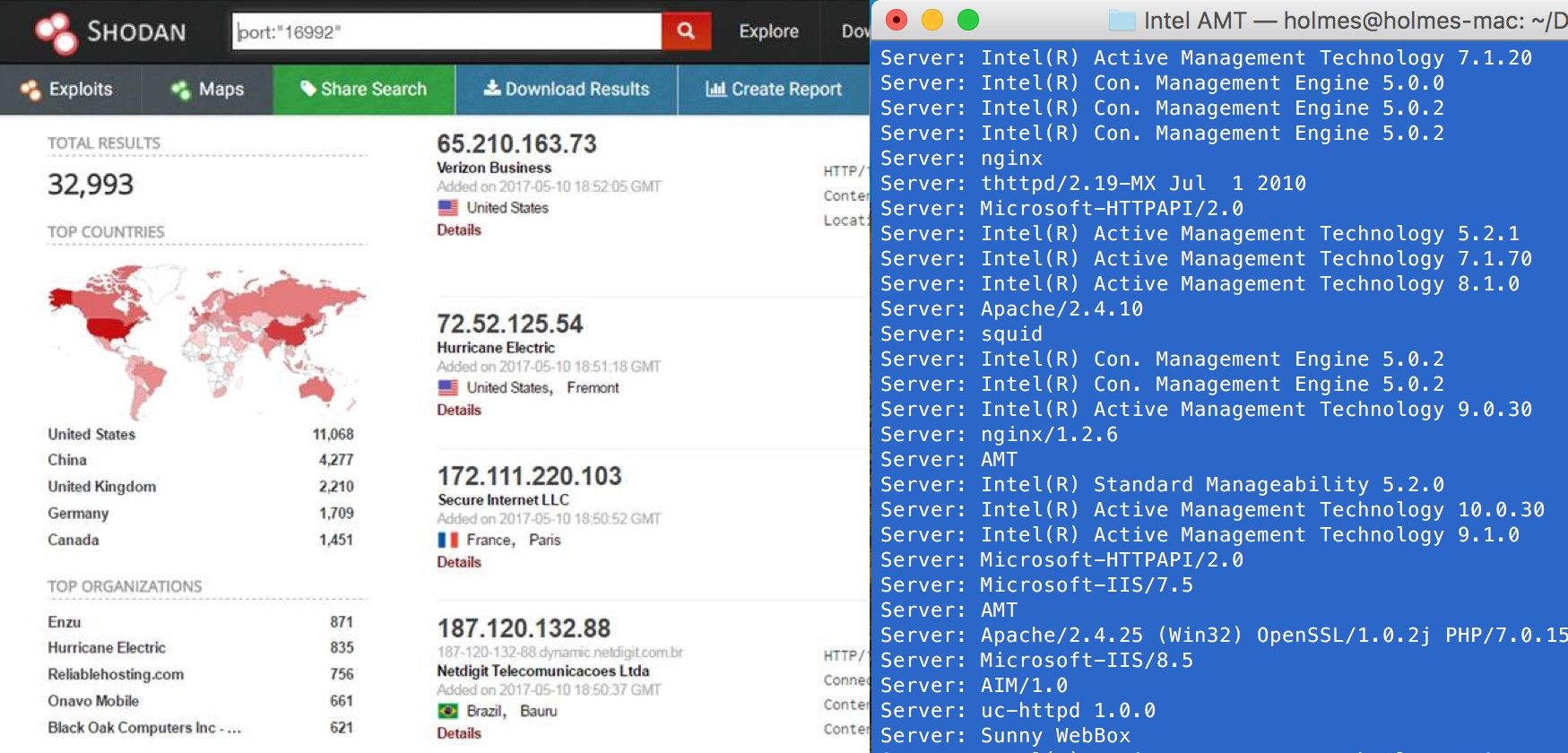

A quick SHODAN search for port 16992 finds a moderate number of hosts (about 33,000). Delving a little deeper into the data shows that, indeed, most of the responses look like they are coming from Intel AMT management servers.

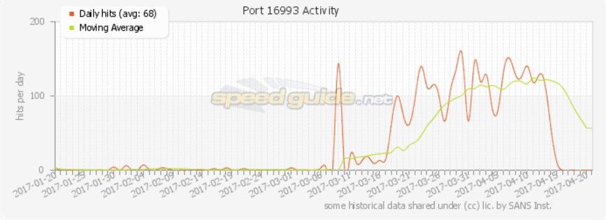

Speed Guide shows a massive spike in the searches for port 16993 in the three months preceding the release of the Intel vulnerability. It is unclear if these scans were from whitehat researchers who were attempting to determine the extent of the exposure, of if it was a malicious actor armed with foreknowledge of the problem. If it was the latter, then that’s scary, isn’t it?
