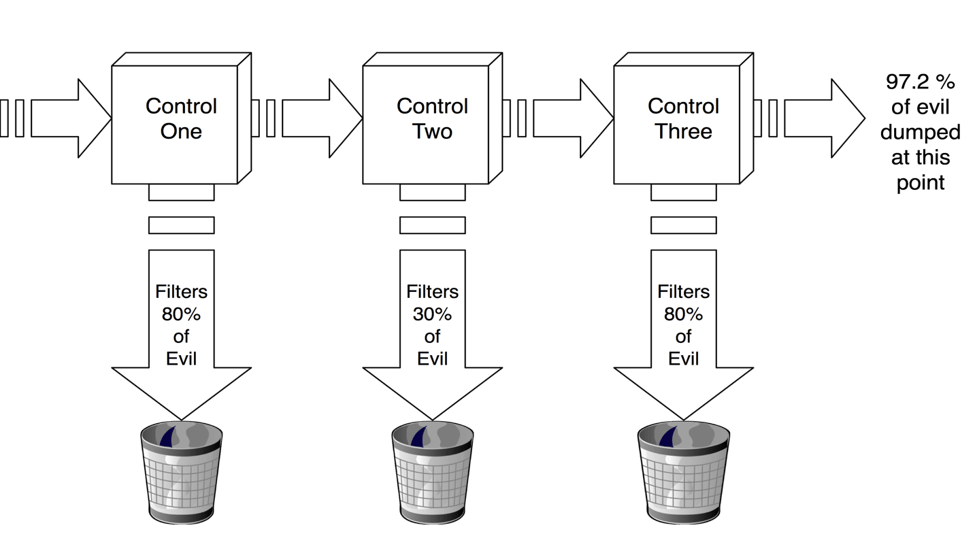

Consider the following diagram:
Say you’ve got a hundred attacks coming into your organization at a given moment. Control Number One filters out 80% of threats to give us only 20 attacks to worry about. Not bad. And then Control Number Two whacks nearly a third of those. Now the total has dropped to 13. Not a great control, but it still reduced things a bit. Finally, Control Number Three takes another 80% off that, dropping the number of attacks to just 3. By overlapping these three limited controls, you’ve created a single control that’s 97% effective.

Another analogy used to describe this defensive thinking is the “Swiss cheese model.”1 Imagine placing various slices of Swiss cheese in a line to block a ray of light passing through. Each barrier has holes, like Swiss cheese, but hopefully enough of them in aggregate will stop most attacks. Like our calculation above, the Swiss cheese model also warns that sometimes the holes of the slices will align for a particular threat and thusly, a few things will slip through every barrier. As in the calculation above, 97% effective still means 3% of attacks get through. No defense is perfect. That is why you need to include some detective and restorative controls as part of defense in depth.
