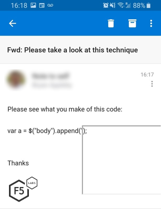

It all began in December 2018, when I received an email from a friend asking for help with some JavaScript code he was investigating. I wasn’t actively hunting for bugs, but the email formatting on my Android phone looked strange. The screenshot below in figure 1, (with PII scrubbed, of course) is the email I received:

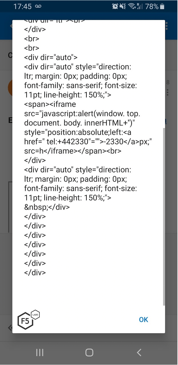

That gray box—it shouldn’t have been there. When I looked closer, it was clear the JavaScript probably contained HTML code for an iframe that would render normally outside of the mobile application. Again, this seemed strange. When I opened it up on a laptop, the code was displayed normally, as you can see below in figure 2:

In a web browser, it’s possible to run JavaScript code by using a URL that starts javascript:. But in a web browser, JavaScript in an iframe on a separate domain shouldn’t have access to the data in the rest of the page. In Outlook on the Android, there is no such restriction. My iframe JavaScript had full access to cookies, tokens and even some emails. Not only that, I could send them back out to a remote attacker.
This kind of vulnerability could be exploited by an attacker sending an email with JavaScript in it. The server escapes that JavaScript and does not see it because it’s within an iframe. When delivered, the mail client automatically undoes the escaping and the JavaScript runs on the client device. Bingo – a stored XSS. This code can do whatever the attacker desires, up to and including stealing information and/or sending data back out. An attacker can send you an email and just by you reading it, they could steal the contents of your inbox. Weaponized, this can turn into a very nasty piece of malware.

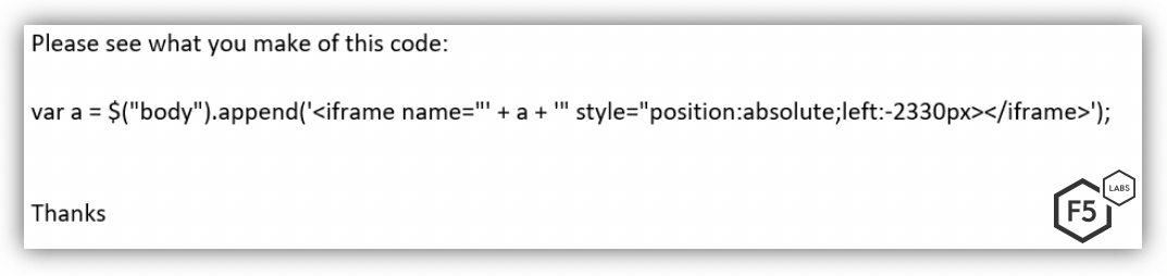

I couldn’t let it go. A few months later, I was still thinking about this vulnerability, and the difficulty in creating a POC for the Microsoft Security Engineers. I remembered this bug and thought about how to extract the rendered HTML from the app. I realized that the key was the bug itself! The bug let me steal data from the app—I could use it to read and extract the HTML.
I constructed a new payload using this information, which can be seen in the screenshot below in Figure 3:
The payload I constructed looked like this:
<iframe src="javascript:alert(window. top. document. body. innerHTML+'')"
style="position:absolute;left:-2330px;" src=h
This payload correctly escaped on the server side with HTML entities. But the escaping was undone on the client, and the payload was converted to:
style="position:absolute;left:<a href=” tel:+442330”=””>-2330</a>px;" src=h</iframe>
The bug occurred in the client-side code, which made the phone number clickable. This bug was not reproducible at first because my Android localization settings were set to UK, which caused the number to be judged as a valid phone number. Other localizations didn’t detect a phone number, so there was no bug.
I rewrote the POC, using a full US phone number format, xxx-xxx-xxxx, and tested that this reproduced across localities. I then sent this back to Microsoft. On March 26,2019, they confirmed the repro and committed to a fix within 90 days of that date.
