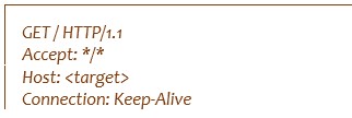

The bot supports HTTP and TCP floods, by sending “GET” requests or just opening (3-way handshake) and closing TCP connections respectively.
Figure 2: Straightforward “GET” attack - perlb0t script

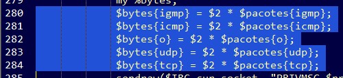

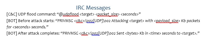

The C&C (Command&Control) instructs its bots to perform a “UDP flood” with 3 parameters:
Target (IP/Domain)
Packet size (in Kbytes)
Duration (in seconds)
Figure 4: Using raw and datagram sockets

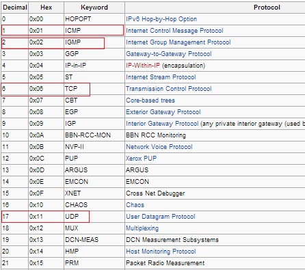

Figure 5: Table of supported IP protocols
By looking at the table of supported IP protocols, we see that the bot creates raw packets of IGMP, ICMP and TCP protocols. Those packets are just being marked with those protocol numbers, however other fields and headers are not actually set. The packet is filled with “A” characters according to the size specified by the C&C command, making the packet a malformed one.

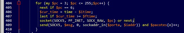

However, even more interesting is the distinction the bot writer makes between the above protocols and other protocols the writer uses afterward. After sending malformed IGMP, UDP, ICMP and TCP packets, the bot will send 252 additional malformed packets of all other protocols (running from 3 to 255 protocol numbers, skipping previously sent protocols).
Figure 6: One loop in the attack
The above screenshot displays a single loop in the attack, while each loop uses a different source port sequentially (running from 1 to 65000). Note the inaccuracy; the bot writer must have meant to run over all the 65k ports, which is 65,536.

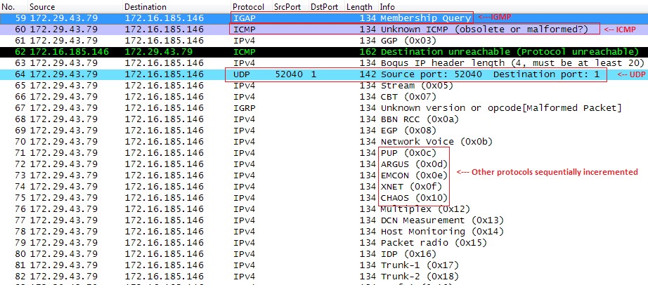

Figure 7: Sample bot traffic
As we see from the bot’s traffic, a sequence of malformed packets is sent (the only well-formed is UDP), while the protocol number is sequentially incremented. (In the screenshot, this is shown as: 0xc, 0xd, 0xe, 0xf, 0x10…) It is important to note, that creating raw sockets needs administrative privileges, so if the infected webserver does not run as the root user, the attack will be a simple UDP flood.

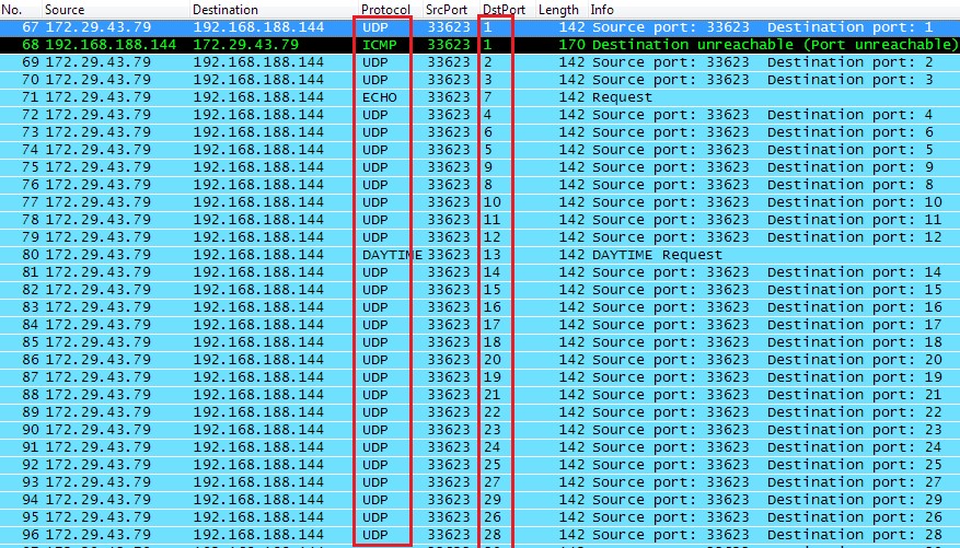

Figure 8: UDP flood
Figure 8: UDP flood
Note the destination port sequence.
