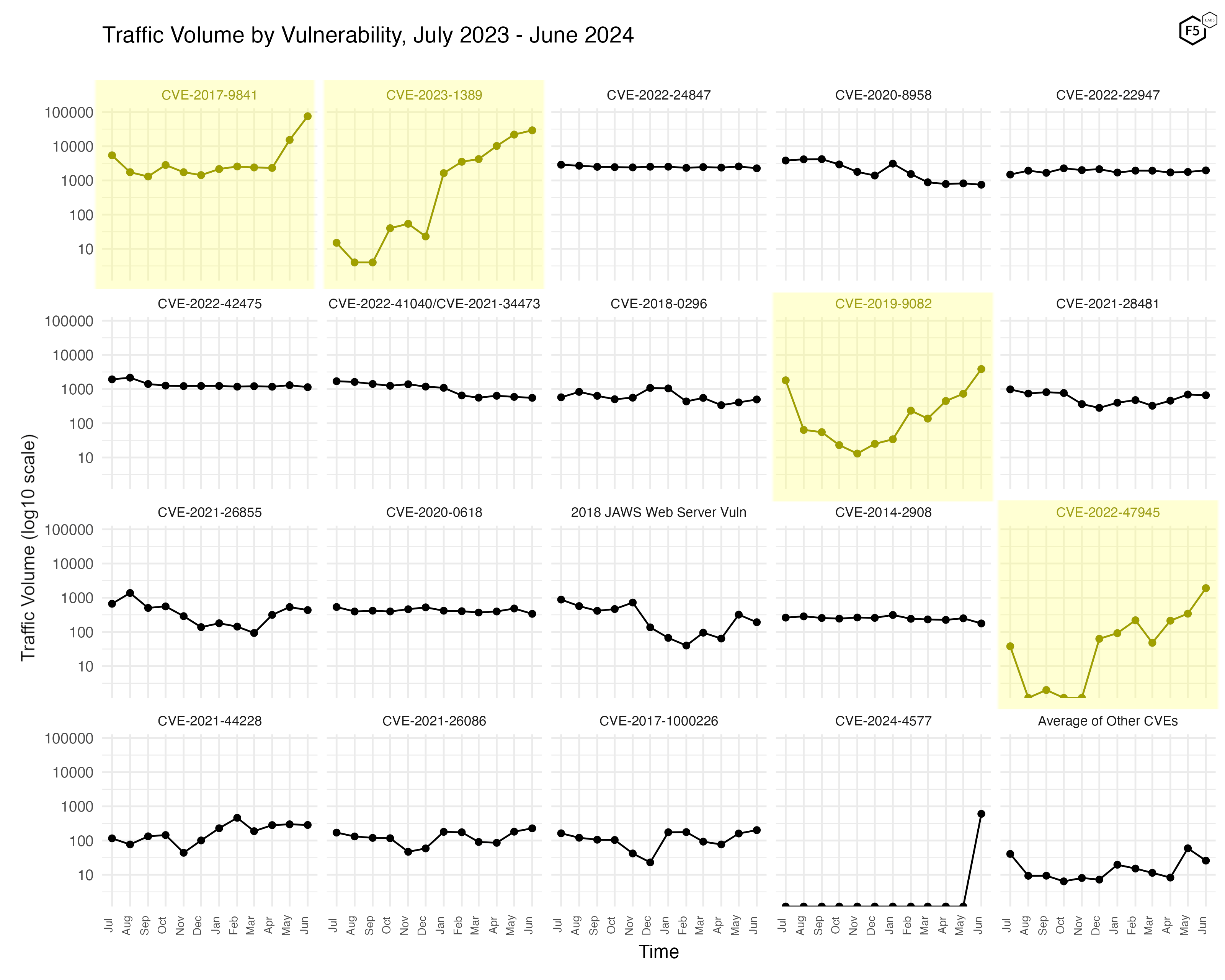

Figure 1 shows June attack traffic for the top ten CVEs that we track. Note the continued presence of CVE-2023-1389, but also the enormous amount of scanning for CVE-2017-9841, continuing a rise that’s been increasing, albeit slowly, since March 2024.
Top 10 CVEs for Ports 80/443, June 2024
Figure 1. Top ten vulnerabilities by traffic volume in June 2024. CVE-2017-9841 is obviously dominant, but CVE-2023-1389 continues to be heavily present. Note also the new top entry of CVE-2022-47945, and the introduction of CVE-2024-4577.
We also note the appearance of a very recent PHP vulnerability, CVE-2024-4577. This is a vulnerability that allows both disclosure of source code and remote code execution on vulnerable versions of PHP running on Windows operating systems using Apache and PHP-CGI. This was announced by Orange Tsai on Friday, June 7th, 2024,1 and we first saw it show up in our scanning logs on the very same day, at 20:10:35 GMT.
Other changes to the top ten include the decline in scanning for CVE-2019-9082, as well as the appearance of CVE-2022-47945 in our top ten. This vulnerability, a ThinkPHP Framework local file inclusion bug, has been in our logs for a long time, but has experienced significant growth in the last month.

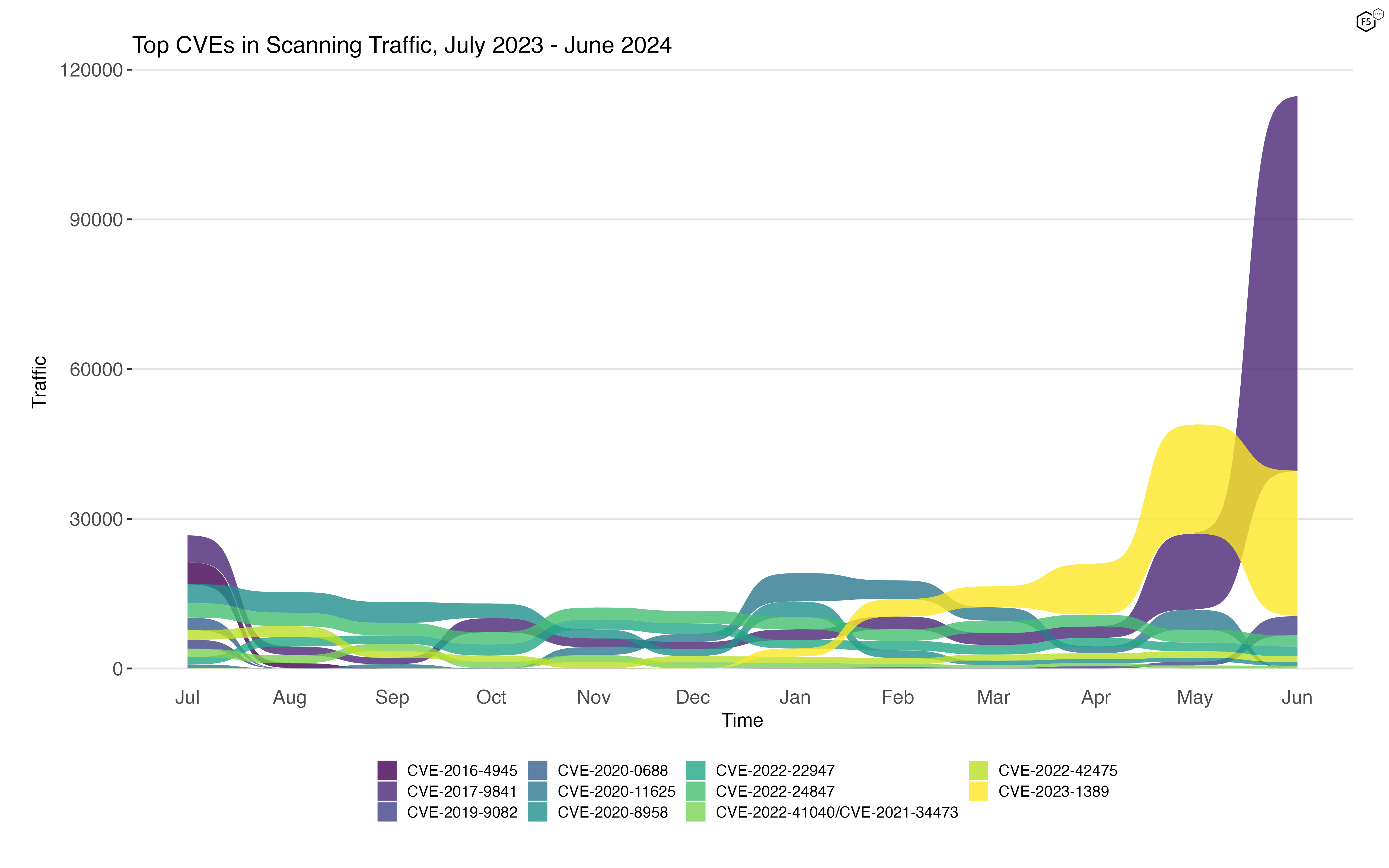

Figure 2 is a bump plot showing the change in traffic volume and position over the last twelve months. This shows very clearly the massive increase in scanning for CVE-2017-9841. Also notable is the continued increase in scanning for CVE-2023-1389, with its total volume (seen in the width of the colored area) indicating that more scanning for this occurred last month than at any time in the previous eleven months.
Figure 2. Evolution of vulnerability targeting in the last twelve months. Note the huge increase in scanning for CVE-2017-9841.
Figure 3 shows traffic for the top 19 CVEs by all-time traffic, followed by a monthly average of the remaining CVEs. This once again shows the dramatic increase in CVE-2017-9841, as well as the movement of CVE-2023-1389, along with modest increases in CVE-2019-9082, and CVE-2022-47945.
Figure 3. Traffic volume by vulnerability. This view accentuates the recent changes in both CVE-2023-1389 and CVE-2017-9841.
