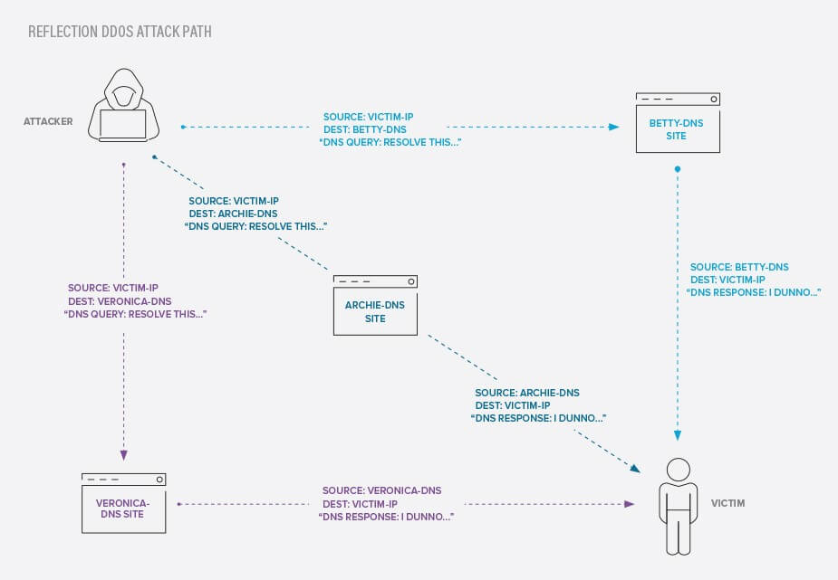

F5 customers are also seeing old fashioned reflection DDoS attacks using spoofed DNS packets. Since DNS uses the non-stateful UDP protocol, an attacker can “reflect” fake DNS requests off of open DNS resolvers to generate storms of DNS requests to deluge their victims, as shown in Figure 1:
Figure 1: How a DNS reflection attack works
When this happens, customers are seeing lots of DNS queries from a wide variety of never-seen-before addresses. Often these requests are for nonsensical domains or even 'localhost' addresses, as they are bot-generated as with the DNS water torture attack. Sometimes attackers will use large Internet DNS resolvers like Yahoo or Google to reflect their attacks off of, so the source addresses may originate there.
If the DNS requests that are clogging up your Internet connections aren’t landing on live addresses, you may see returning ICMP Destination Unreachable messages bouncing back out from your network, which also add to the traffic jam. In these kinds of attacks, the DNS reflection attack acts like a network-volumetric DDoS, designed to fill up your pipes with traffic rather than targeting a specific service or host.
