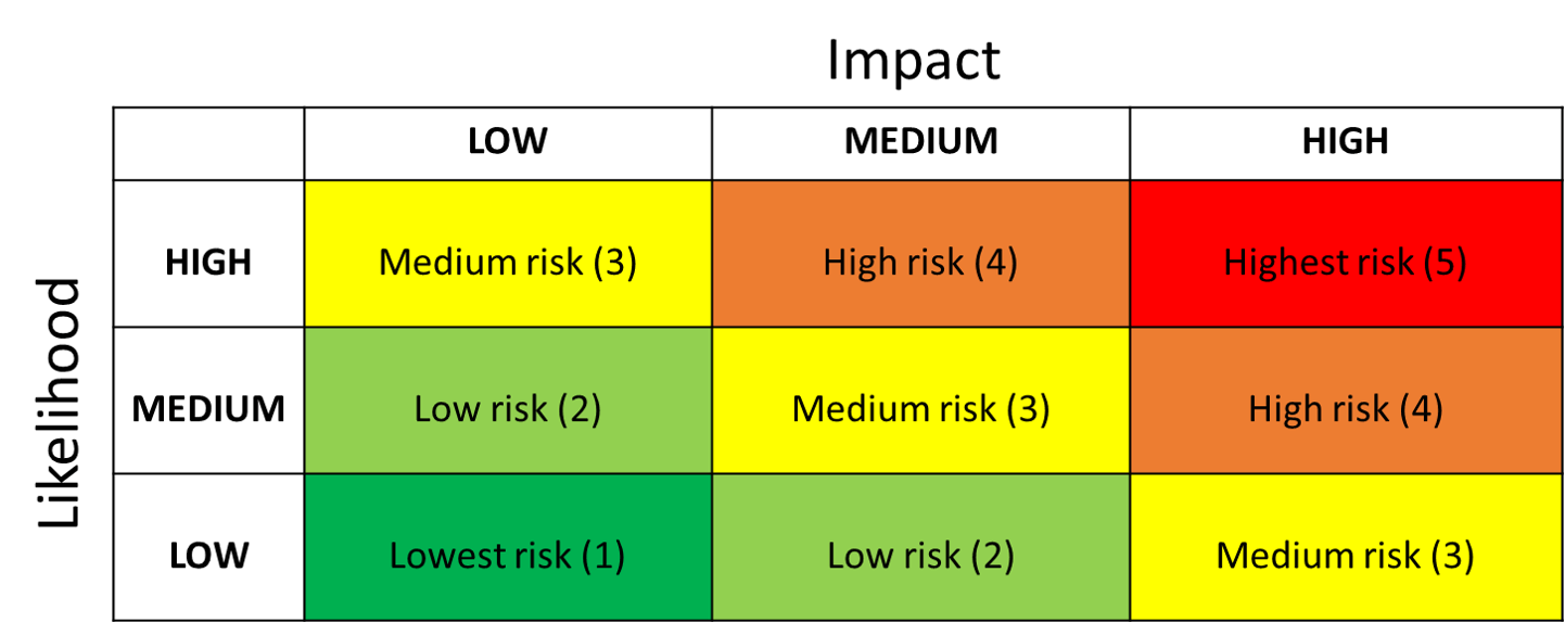

Assuming a matched vulnerability and threat exists, it’s essential to consider both likelihood and impact to determine the level of risk. A simple, qualitative (versus quantitative)6 risk matrix like the one shown in Figure 1 illustrates the relationship between the two. (Note that there are many variations of this matrix, some far more granular and detailed.)
Using our earlier example, yes, the loss of a company’s primary ecommerce website could have a significant impact on revenue, but what is the likelihood of that happening? If it’s low, the risk level is medium. Similarly, if an attack on a seldom-used, low-revenue-generating web app is highly likely, the level of risk is also medium. So, statements like, “If this machine gets hacked, all our data is owned!” or “Our password lengths are too short and that’s risky!” are incomplete and only marginally useful because neither one addresses both likelihood and impact.1
