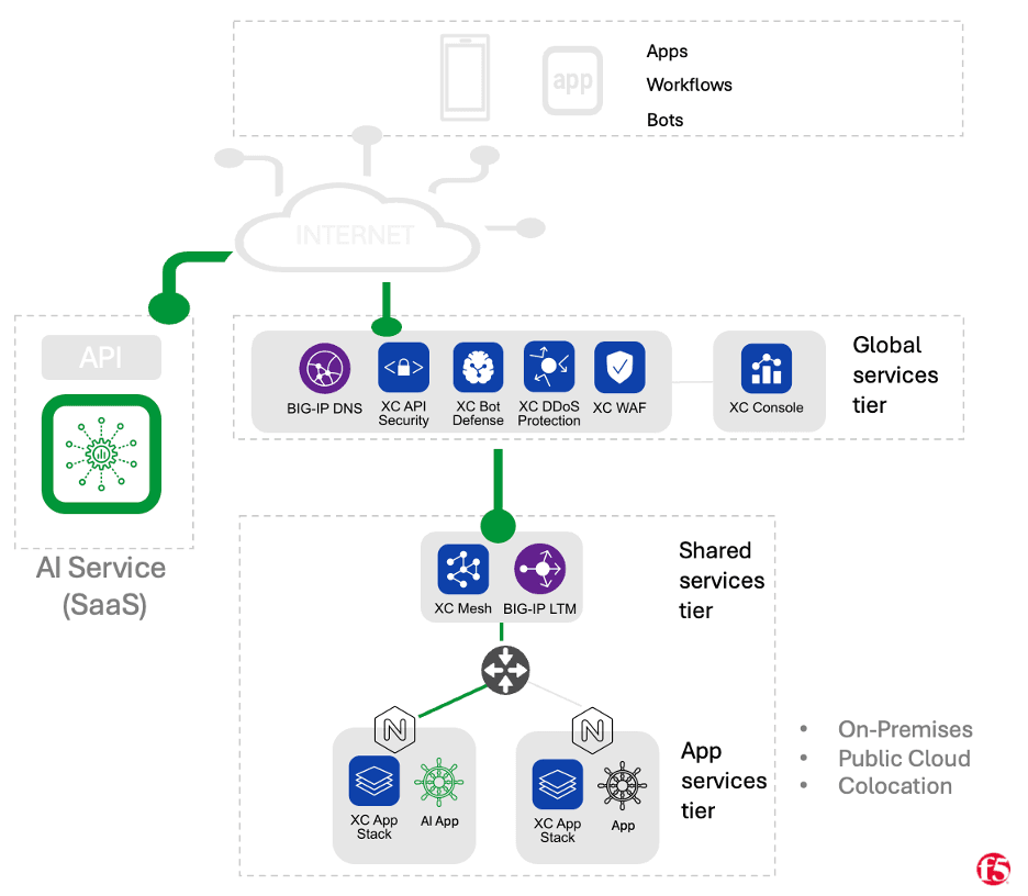

SaaS Pattern
Saas Pattern Diagram
Organizations may choose to consume services from a dedicated SaaS provider which focuses on hosting AI models for inference (such as OpenAI or Cohere). In this case, workloads running on an organization’s infrastructure (be it private data center, colocation, or public cloud) leverage APIs published by the SaaS provider. With this pattern, the burden associated with operating the infrastructure required for hosting the models falls entirely on the SaaS provider, and the time it takes to get up and running can be very brief. These benefits, however, come at the cost of control, with this pattern being the least “flexible” of the ones we’ll cover. Likewise control over sensitive data is typically lowest with this model, where the public internet is usually used to connect with the service, and the external SaaS vendor is less likely to be able to address stringent regulatory compliance concerns.
Well Suited For
  • Time to Market: Rapid prototyping, MVP releases.
  • Organizations without significant in-house AI inferencing expertise/experience.
  • Applications without significant or stringent data security/governance needs.
Strengths
  • Short time to market: Simple operational model can lead to short integration times.
  • Focused service providers are well equipped to deal with inference scaling challenges.
  • Doesn’t require investment in specialized hardware or personnel.
Challenges
  • Latency and connectivity concerns relative to services collocated with app workloads.
  • Data privacy, governance, and security concerns are reliant on (or may be incompatible with) an external SaaS provider.
  • Operating expense cost at larger scales may be higher than self-hosting models.
  • Custom model hosting and model customization services may not be supported.

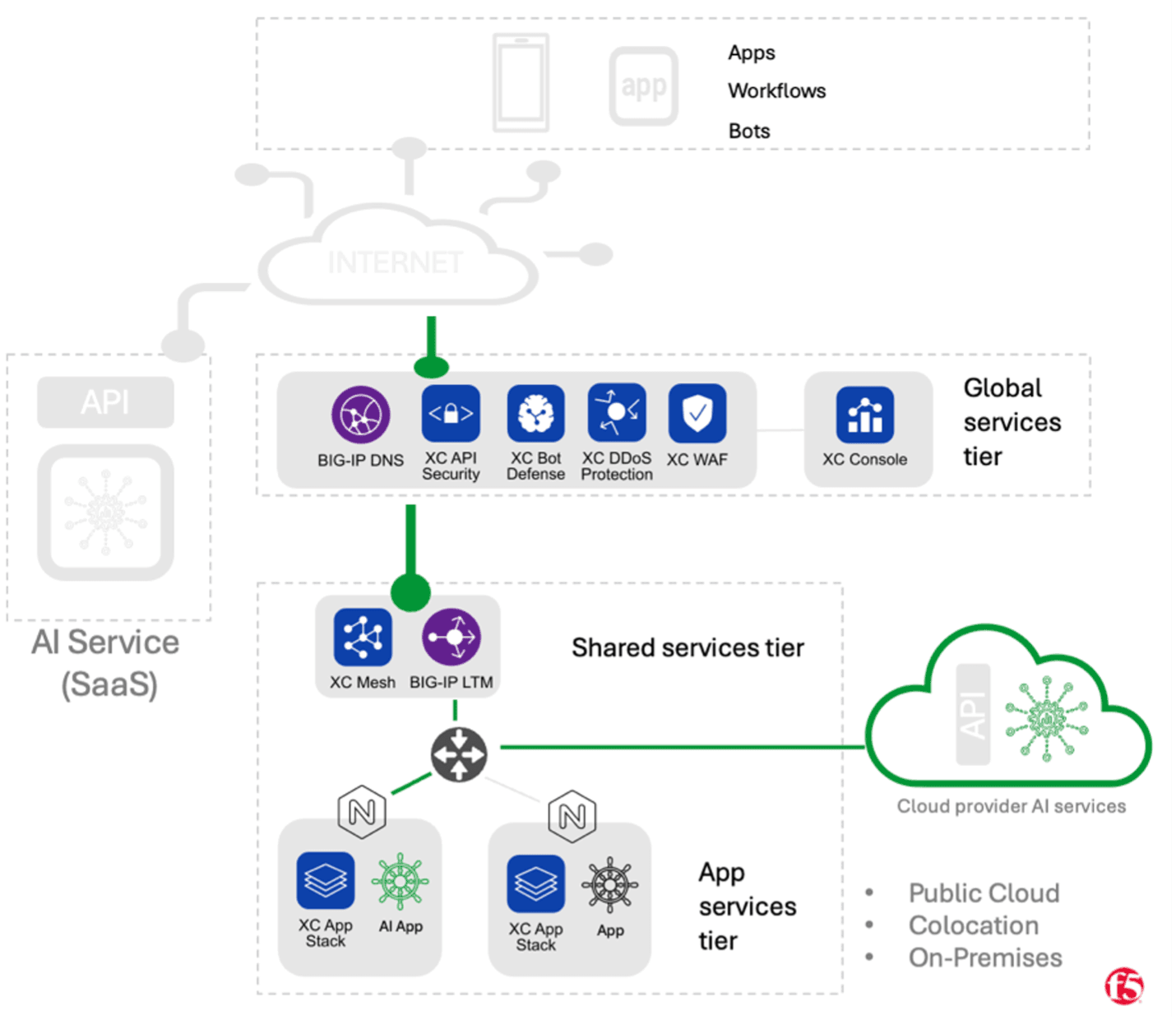

Cloud Managed Pattern
Cloud Manged diagram
In this pattern, organizations leverage managed services provided by public cloud providers (for example, Azure OpenAI, Google Vertex, AWS Bedrock). As with the first pattern, the operational burden for deploying, scaling, and maintaining the AI models falls on the Cloud Provider rather than the consuming organization. The major difference between this pattern and the SaaS pattern above, is that in this case the inference API endpoints are generally accessible via private networks, and AI consumer workloads can be collocated with the AI Model service (e.g., same zone, region). As a result, the data typically doesn’t transit the public internet, latency is likely to be lower, and mechanisms for connecting to these services are similar to those for other cloud provider managed services (i.e., service accounts, access policies, network ACLs). Organizations leveraging multi-cloud networking may be able to realize some of these same benefits even in cases where workloads and AI inference services are hosted in different clouds.
Well Suited For
  • Organizations with existing public cloud investments.
  • Applications running in, or connecting to, other cloud managed services.
Strengths
  • Many organizations are already familiar with connecting their workloads to other cloud provider managed services (e.g., databases, object stores, etc.).
  • The operational and infrastructure burden for running and scaling models lands primarily on the cloud provider.
  • Latency concerns and some data privacy concerns may be easier to address.
Challenges
  • Multi/Hybrid cloud applications require additional effort to connect and secure.
  • Lack of uniformity across cloud managed services and APIs may lead to vendor lock-in.
  • Organizations without an extensive public cloud presence may face difficulties.
  • Operational expense cost at larger scales may be higher than self-hosting models.

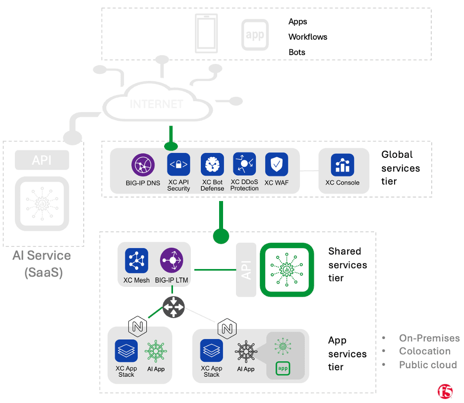

Self-Managed Pattern
self manage diagrap
For the self-managed model, we’ll first discuss the case where AI model inference is run as a centralized “shared service,” then examine the case where no centralized service exists, and operational concerns are left up to individual application teams.
Self-Managed, Shared Service
In the “Shared Service” variant of the Self-Managed pattern, an organization may have dedicated team(s) responsible for maintaining inference infrastructure, the models that run on it, the APIs used to connect to it, and all operational aspects of the inference service lifecycle. As with the other patterns, AI application workloads would consume inference services through API calls. The model serving infrastructure might run in private data centers, public cloud, or at a colocation facility. The teams responsible for operating the inference service may take advantage of self-hosted machine learning platforms (such as Anyscale Ray or MLFlow). Alternatively, they might rely on more narrowly focused inference serving tools like Hugging Face’s Text Generation Inference server or software developed in-house. With self-managed inference, organizations are limited to using models that either they’ve trained themselves or are available to run locally (so proprietary models from a SaaS oriented service may not be an option).
Well Suited For
  • Mature organizations with extensive infrastructure management experience.
  • Organizations with heavy inference requirements that justify the TCO of a self-managed service.
  • Applications with the most stringent data privacy and compliance requirements.
Strengths
  • Organizations are in complete control of all aspects of the inference service.
  • Data privacy challenges are typically easiest to address with self-hosted models.
  • Cost at large scale may be more efficient than cloud managed or SaaS based inference services.
Challenges
  • Organizations are in complete control of all aspects of the inference service (large infrastructure and staffing investments are likely to be required, along with ongoing maintenance, development, scalability concerns).
  • Not typically cost effective for organizations with minimal inferencing needs and minimal data privacy concerns.
  • No access to closed / proprietary models that may be available as SaaS or cloud managed services.
Self-Managed, Not A Shared Service
Organizations without a central team responsible for running AI inference services for applications to consume is the other variant of the Self-Managed pattern. In this version, individual application teams might run their models on the same infrastructure that’s been allocated to them for the application workload. They may choose to access those models via API or consume them directly in an “offline” fashion. With this pattern, developers may be able to realize some of the same benefits as the “Shared Service” self-managed model at a smaller scale.
Well Suited For
  • Applications requiring batch processing and offline inference.
  • Organizations with very light inference consumption, but strict data privacy and compliance requirements.
Strengths
  • Most flexible for application developers, allowing a wide range of possibilities for integration with workloads.
  • Can achieve data privacy and latency targets at small scale.
  • May be more cost effective than the other models discussed in some cases (such as single team with heavy consumption requirements).
Challenges
  • The operational burden for the model lifecycle is placed on individual application teams.
  • Fails to take advantage of economies of scale as an organization’s consumption of AI inference grows (lack of consistency, inefficient resource utilization, etc.)

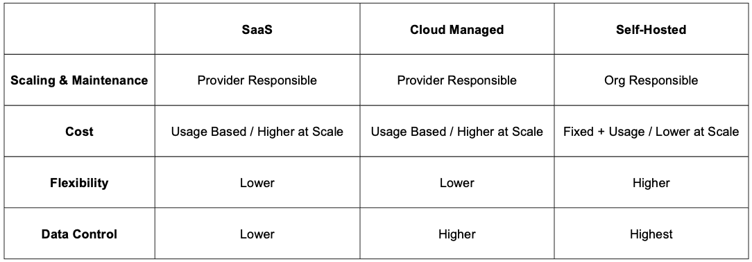

Summary Of Pattern Tradeoffs
saas chart
