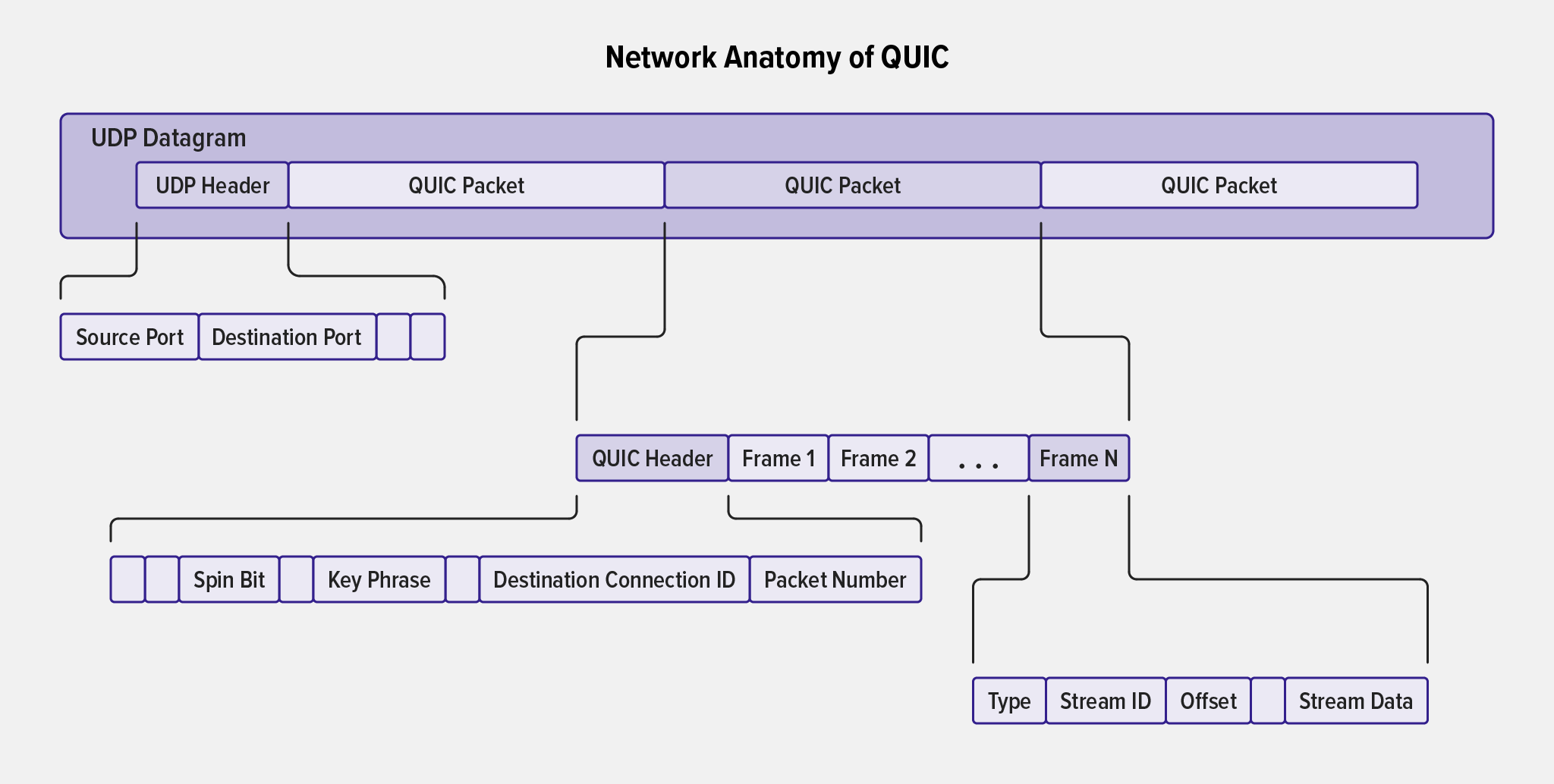

A Simplified QUIC Network Anatomy
QUIC streams are the logical objects containing HTTP/3 requests or responses (or any other application data). For transmission between network endpoints, they are wrapped inside multiple logical layers as depicted in the diagram.
Figure 1. Anatomy of a QUIC stream
Starting from the outside in, the logical layers and objects are:
  • UDP Datagram – Contains a header specifying the source and destination ports (along with length and checksum data), followed by one or more QUIC packets. The datagram is the unit of information transmitted from client to server across the network.
  • QUIC Packet – Contains one QUIC header and one or more QUIC frames.
  • QUIC Header – Contains metadata about the packet. There are two types of header:
    • The long header, used during connection establishment.
    • The short header, used after the connection is established. It contains (among other data) the connection ID, packet number, and key phase (used to track which keys were used to encrypt the packet, in support of key rotation). Packet numbers are unique (and always increase) for a particular connection and key phase.
  • Frame – Contains the type, stream ID, offset, and stream data. Stream data is spread across multiple frames, but can be assembled using the connection ID, stream ID, and offset, which is used to present the chunks of data in the correct order.
  • Stream – A unidirectional or bidirectional flow of data within a single QUIC connection. Each QUIC connection can support multiple independent streams, each with its own stream ID. If a QUIC packet containing some streams is lost, this does not affect the progress of any streams not contained in the missing packet (this is critical to avoiding the head-of-line blocking experienced by HTTP/2). Streams can be bidirectional and created by either endpoint.

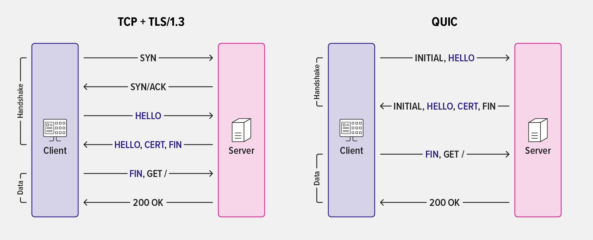

In Connection Establishment, we alluded to the fact that the initial QUIC handshake does more than simply establish a connection. Unlike the TLS handshake for TCP, with UDP the exchange of keys and TLS 1.3 encryption parameters occurs as part of the initial connection. This feature removes several exchanges and enables zero round‑trip time (0‑RTT) when the client resumes a previous connection.
Figure 4. Comparison of the encryption handshakes for TCP+TLS/1.3 and QUIC

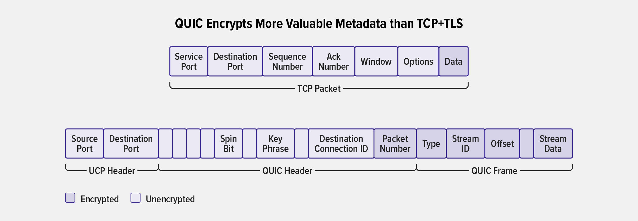

In addition to folding the encryption handshake into the connection‑establishment process, QUIC encrypts a greater portion of the metadata than TCP+TLS. Even before key exchange has occurred, the initial connection packets are encrypted; though an eavesdropper can still derive the keys, it takes more effort than with unencrypted packets. This better protects data such as the Server Name Indicator (SNI) which is relevant to both attackers and potential state‑level censors. Figure 5 illustrates how QUIC encrypts more potentially sensitive metadata (in red) than TCP+TLS.
Figure 5. QUIC encrypts more sensitive metadata than TCP+TLS
All data in the QUIC payload is encrypted using TLS 1.3. There are two advantages: older, vulnerable cipher suites and hashing algorithms are not allowed and forward secrecy (FS) key‑exchange mechanisms are mandatory. Forward secrecy prevents an attacker from decrypting the data even if the attacker captures the private key and a copy of the traffic.

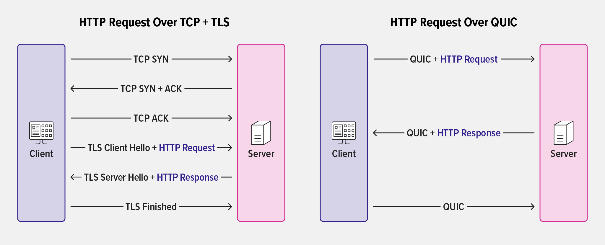

Reducing the number of round trips that must happen between a client and server before any application data can be transmitted improves the performance of applications, particularly over networks with higher latency.
TLS 1.3 introduced a single round trip to establish an encrypted connection, and zero round trips to resume a connection, but with TCP this means the handshake has to occur before the TLS Client Hello.
Because QUIC combines cryptographic operations with connection setup, it provides true 0‑RTT connection re‑establishment, where a client can send a request in the very first QUIC packet. This reduces latency by eliminating the initial roundtrip for connection establishment before the first request.
Figure 6. Comparison of the messages required to re-establish a connection with TCP+TLS versus QUIC
In this case, the client sends an HTTP request encrypted with the parameters used in a previous connection, and for address‑validation purposes includes a token supplied by the server during the previous connection.
Unfortunately, 0‑RTT connection resumption does not provide Forward Secrecy, so the initial client request is not as securely encrypted as other traffic in the exchange. Requests and responses beyond the first request are protected by Forward Secrecy. Possibly more problematic is that the initial request is also vulnerable to replay attacks, where an attacker can capture the initial request and replay it to the server multiple times.
For many applications and websites, the performance improvement from 0‑RTT connection resumption outweighs these potential vulnerabilities, but that’s a decision you need to make for yourself.
This feature is disabled by default in NGINX. To enable it, set the ssl_early_data directive to on.

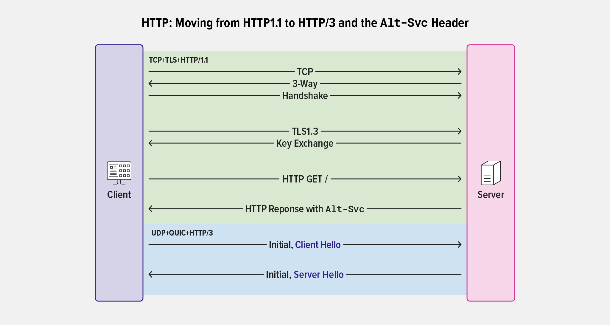

Moving from HTTP/1.1 to HTTP/3 with the Alt-Svc Header
Nearly all clients (browsers in particular) make initial connections over TCP/TLS. If a server supports QUIC+HTTP/3, it signals that fact to the client by returning an HTTP/1.1 response that includes the h3 parameter to the Alt-Svc header. The client then chooses whether to use QUIC+HTTP/3 or stick with an earlier version of HTTP. (As a matter of interest, the Alt-Svc header, defined in RFC 7838, predates QUIC and can be used for other purposes as well.)
Figure 7. How the Alt-Svc header is used to convert a connection from HTTP/1.1 to HTTP/3
The Alt-Svc header tells a client that the same service is available on an alternate host, protocol, or port (or a combination thereof). In addition, clients can be informed how long it’s safe to assume that this service will continue to be available.
Some examples:
Alt-Svc: h3=":443" HTTP/3 is available on this server on port 443Alt-Svc: h3="new.example.com:8443" HTTP/3 is available on server new.example.com on port 8443Alt-Svc: h3=":8443"; ma=600 HTTP/3 is available on this server on port 8443 and will be available for at least 10 minutes
Although not mandatory, in most cases servers are configured to respond to QUIC connections on the same port as TCP+TLS.
To configure NGINX to include the Alt-Svc header, use the add_header directive. In this example, the $server_port variable means that NGINX accepts QUIC connections on the port to which the client sent its TCP+TLS request, and 86,400 is 24 hours:
add_header Alt-Svc 'h3=":$server_port"; ma=86400';
