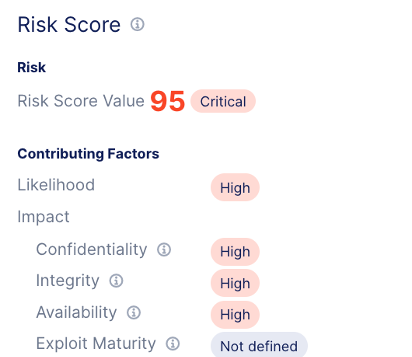

Here’s what one of those blocked requests looked like inside F5 WAF for Distributed Cloud:

AI-powered WAF rated a PHP2Shell attack request 95 out of 100, critical risk, based on what it had already learned from past attacks. Best practice: configure for the outcome you want.
For PHP2Shell, that verdict was 95 out of 100. The malicious requests were blocked on the spot, and legitimate traffic kept flowing.
