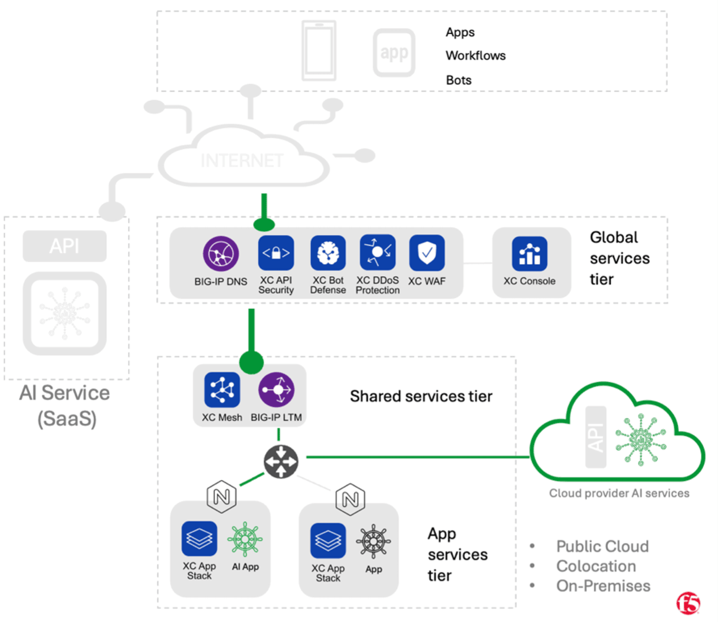

Cloud Managed Pattern
Cloud Manged diagram
In this pattern, organizations leverage managed services provided by public cloud providers (for example, Azure OpenAI, Google Vertex, AWS Bedrock). As with the first pattern, the operational burden for deploying, scaling, and maintaining the AI models falls on the Cloud Provider rather than the consuming organization. The major difference between this pattern and the SaaS pattern above, is that in this case the inference API endpoints are generally accessible via private networks, and AI consumer workloads can be collocated with the AI Model service (e.g., same zone, region). As a result, the data typically doesn’t transit the public internet, latency is likely to be lower, and mechanisms for connecting to these services are similar to those for other cloud provider managed services (i.e., service accounts, access policies, network ACLs). Organizations leveraging multi-cloud networking may be able to realize some of these same benefits even in cases where workloads and AI inference services are hosted in different clouds.

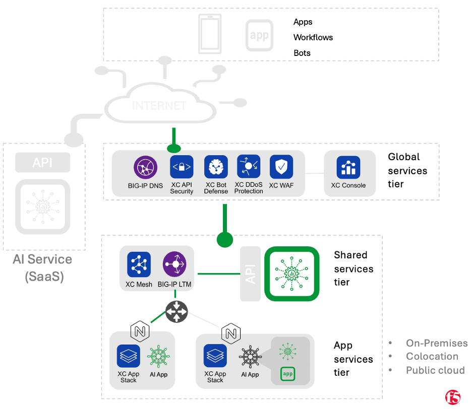

Self-Managed Pattern
self manage diagrap
For the self-managed model, we’ll first discuss the case where AI model inference is run as a centralized “shared service,” then examine the case where no centralized service exists, and operational concerns are left up to individual application teams.
Self-Managed, Shared Service
In the “Shared Service” variant of the Self-Managed pattern, an organization may have dedicated team(s) responsible for maintaining inference infrastructure, the models that run on it, the APIs used to connect to it, and all operational aspects of the inference service lifecycle. As with the other patterns, AI application workloads would consume inference services through API calls. The model serving infrastructure might run in private data centers, public cloud, or at a colocation facility. The teams responsible for operating the inference service may take advantage of self-hosted machine learning platforms (such as Anyscale Ray or MLFlow). Alternatively, they might rely on more narrowly focused inference  serving tools like Hugging Face’s Text Generation Inference server or software developed in-house. With self-managed inference, organizations are limited to using models that either they’ve trained themselves or are available to run locally (so proprietary models from a SaaS oriented service may not be an option).

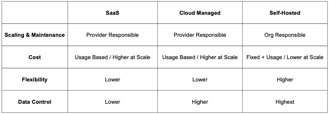

Summary Of Pattern Tradeoffs
