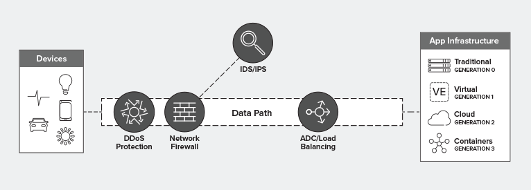

There are options, of course. The data path contains multiple insertion points at which a WAF can be deployed. But that doesn’t mean every insertion point is a good idea. Some are less efficient than others, some introduce unacceptable points of failure, and others introduce architectural debt that incurs heavy interest penalties over time.

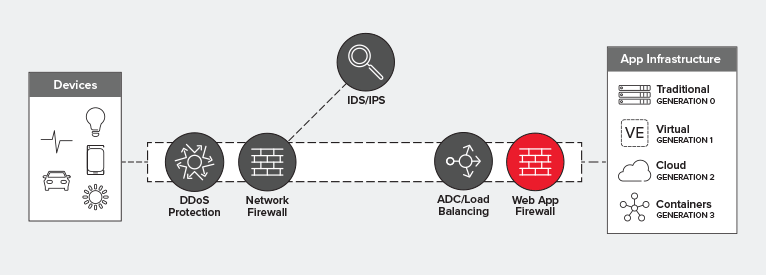

Ideally, you’ll deploy a WAF behind your load balancing tier. This optimizes for utilization, performance, and reliability while providing the protection necessary for all apps – but particularly for those exposed on the Internet.
Recommended Placement: WAF behind Load Balancing Tier

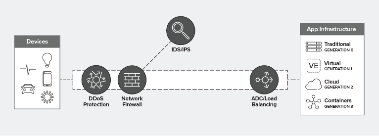

Alternative Placement: WAF in front of One Load Balancing Tier...and behind Another
Performance
Performance is a key concern in an application economy. With so many variables and systems interacting with data as it traverses the data path, it can be frustrating to nail down exactly where performance is being bogged down let alone to tune each one without impacting others. As has been noted many times before, as load on a system increases, performance decreases. This is one of the unintended consequences of not optimizing for utilization, and a key reason why seasoned network architects use a 60% utilization threshold on network devices.
Deploying a WAF behind the LB tier eliminates the need for an upstream designated WAF load balancing tier, which removes an entire layer of network from the equation. While the processing time eliminated may not seem like much, those precious microseconds spent managing connections and scaling WAF services and then doing it again to choose a target app instance/server matters. Eliminating this tier by deploying the WAF behind the LB tier gives back precious microseconds that today’s users will not only notice, but appreciate.
