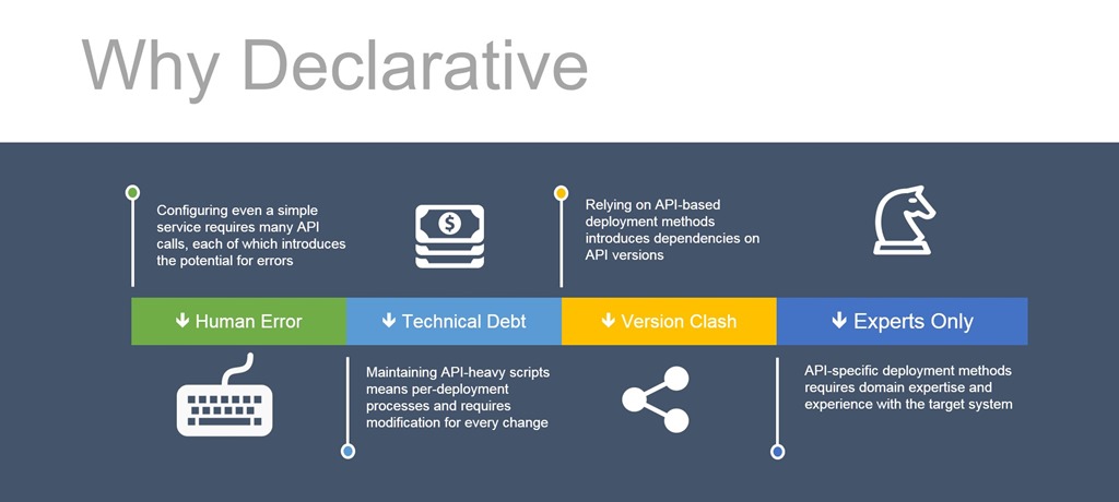

Now to answer the question as to why this is important. There are four primary benefits to adopting a declarative model when you’re moving to automate all the things.
1. Reduce Human Error
We know that something like 22% of outage incidents in production occur because of human error. Some fairly high-profile incidents, which I’ll not hash out yet again, have been directly traced to simple human error. In an imperative model, relying on API calls, each one is a potential incident waiting to happen. If you didn’t verify a variable, or forgot to check for an error code, or a hundred other possible scenarios, you may experience a resume-generating event. That’s a bad thing.
A declarative model is based on a template or configuration file of some kind that will be parsed and validated before API calls are used to execute against it. While you can certainly still mess up a configuration file or template, the opportunities to do so are limited because you’re reducing the code required. And less code generally means fewer opportunities to make a mistake.
2. Reduce Technical Debt
Technical debt is that fun metaphor we picked up from development that reminds us of the long-term cost of our choices. Technical debt mounts with imperative models in several ways. First, there’s the coupling of the scripts to the API of our target system. That API isn’t likely to support anything else, which means we’re developing scripts on a per-system basis. The configuration steps will also likely vary from app to app – not everything is HTTP, and not every HTTP-based application requires exactly the same service configuration. So now we’re building scripts on a per-app, per-system basis. That’s a lot of scripts, and a lot of debt mounting based on that choice.
Conversely, a declarative method can use the same deployment process script and system. While the template/configuration will still likely be application and system-specific, it’s a single file. It eliminates the complexity and number of scripts and thus dramatically reduces technical debt. The reality is there’s always going to be some debt incurred by our choices; minimizing it is the goal.
3. Eliminate Version Clashes
When you tie your configuration and deployment processes to an API, you are tied to that version of the API. There are plenty of communities on the Internet with hostile, angry developers sounding off about changes to an API and the work required to change their app. The same thing can (and will) happen with network and application services. So if you’re tied to one version of the API and something changes, guess what? You’re going to be updating (or perhaps rewriting) scripts until the cows come home*.
But if you’ve adopted a declarative model, you’re likely going to be able to ignore any changes to the API. After all, you’re not using the API to tell the system how to deploy a service, you’re just telling it what needs to be deployed.
4. Reduce Domain Expertise Requirements
Let’s face it, if I’m going to use an API for a network or application service, I have to understand the system. If you don’t know the difference between a virtual IP and a virtual server, well, you’re in trouble already and we’ve barely gotten to nodes versus members. Imperative, API-based methods require you understand the target system well-enough to navigate its configuration.
Using a declarative model, you need less expertise in the target system, which means developers and DevOps alike are more likely to be able to use the method to self-service applications. You’ll still need experts, of course, but the demands on consumers of the services is lessened and spreads out the burden of provisioning and deployment across a broader set of constituents.
There are other reasons why you’d want to adopt a declarative model for your NetOps automation efforts, but these four are the most compelling. That’s because they benefit NetOps, the business, and the broadening constituents who need self-service access to the network and application services that make apps go faster and safer.
