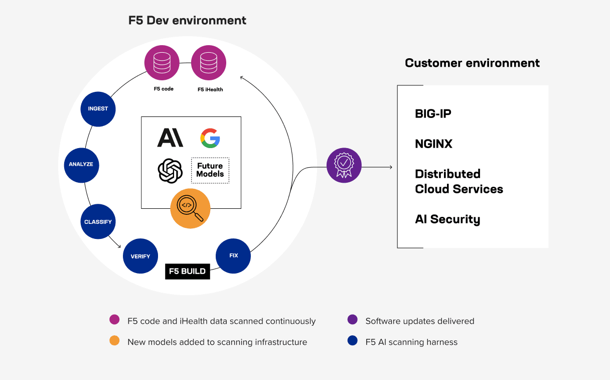

Regardless of the tool, the scanning infrastructure follows a rigorous, multistep process that looks like the following:
  1. Ingest. We feed the codebase across major modules and languages so the models can reason over real implementation details, not summaries or abstractions.
  2. Analyze. We run AI-driven static analysis to detect bugs, risky patterns, and suspicious flows: broken auth logic, insecure crypto, memory safety issues, and more.
  3. Classify. We extract structured findings, including CWE mappings, severity assessments, file and line references, and exploitability context.
  4. Verify. A second model confirms, downgrades, or rejects findings before they enter the engineering pipeline. This is where the false-positive problem is challenged. Early on, this step did not exist in any meaningful form, and the noise was overwhelming. Today, it is one of the most important parts of the system.
  5. Fix. Validated findings are routed into prioritized remediation. Fixes are built, tested, and shipped.
Each cycle builds a knowledge base that makes the next cycle faster and more precise. Over time, the codebase itself becomes more resistant. The models find less because there is less to find. That’s the compounding effect we are investing in.
F5’s scanning infrastructure follows a vigorous, multistep process
F5’s scanning infrastructure follows a vigorous, multistep process.
