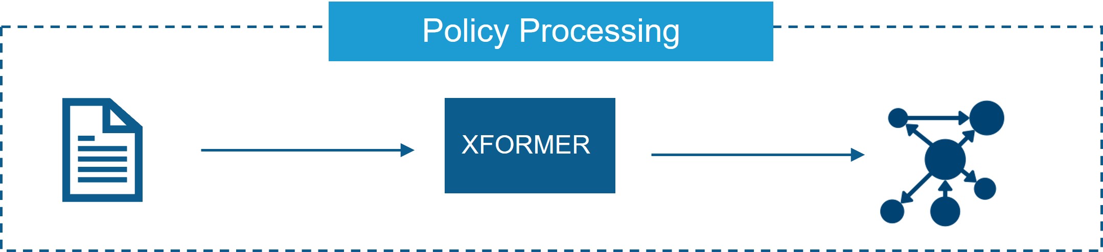

pc graph architecture
The PC-graph architecture consists of components to transform DEX into a graph representation. The resulting graph data is then stored in a Neo4j database. Output from a GPT agent can be submitted via API to a GraphQL Apollo server, which executes the query against the graph database.

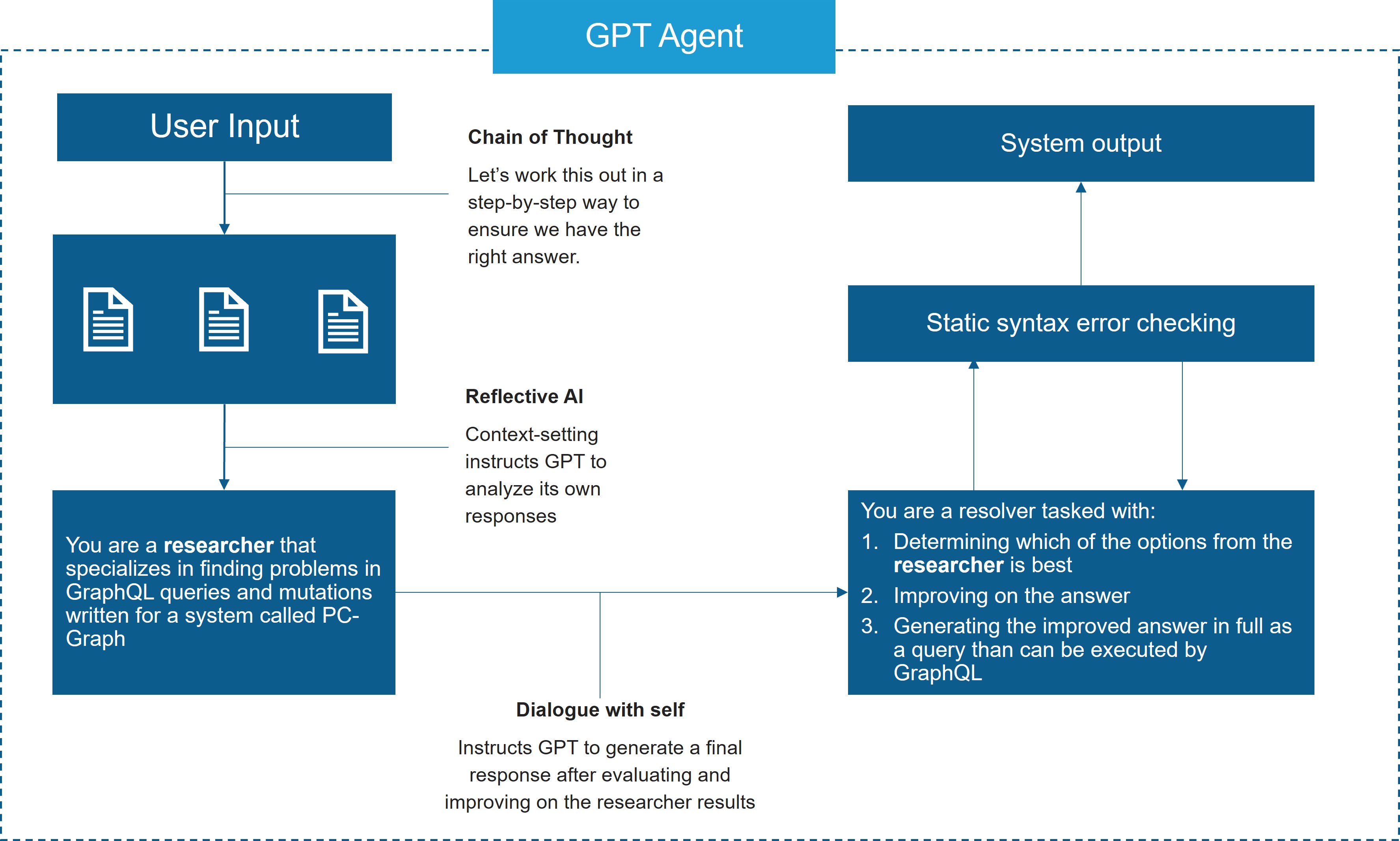

Our agent uses GPT4 to respond to requests in natural language for information about policies written in DEX. The agent achieves this by understanding the pc-graph API and responding with an appropriate query or mutation that can then be reviewed and executed by the user.
In addition to the pc-graph API, our agent also understands the libraries used and some concepts about the DEX language. This information is carefully selected to be included in the context at runtime to provide optimal results.

We have found three AI approaches that improve results from GPT4:
  1. Chain of Thought
    • Chain of Thought (CoT) is an AI concept that simulates human-like thought processes, allowing systems to follow a logical sequence of ideas or concepts, similar to how humans connect thoughts in a chain-like fashion. This aids in natural language understanding, reasoning, and context comprehension. This technique produces the best results when applied to the state-of-the-art model GPT-4.
  2. Reflective AI
    • Reflective AI, also known as self-aware AI or AI with reflective capabilities, refers to artificial intelligence systems that possess the ability to introspect and make decisions about their own actions and processes. This level of AI goes beyond traditional machine learning and basic decision-making capabilities, as it involves a higher degree of self-awareness and self-assessment. Reflexion, a framework for language agents with verbal reinforcement learning, “verbally reflects on task feedback signals, then maintains their own reflective text in an episodic memory buffer to induce better decision-making in subsequent trials."
  3. Dialoging with itself
    • Dialog-enabled resolving agents (DERA) was presented as a method to iteratively improve output of LLMs by communicating feedback. The technique uses two agents: a researcher for information processing and a decider for final judgments. The interaction is framed as a dialogue between the agents and imbues the decider with autonomy to make judgements on the final output.
As a last step, we make use of tools that provide static syntax error checking for GraphQL queries to catch any possible hallucinations that have slipped past the initial mitigations.
gpt agent diagram
This design is further improved by initially generating three potential answers in the same prompt. This not only reduces the time and cost for a given prompt but also improves consistency as correct aspects of an answer are more likely to occur. Doing this we also have room for random variation in the interest of exploring unlikely but accurate options.
As a result of our approach we’ve been able to garner insights from policies without sharing private data. The quality and consistency of our query results have also improved remarkably with a notable reduction in hallucinations, particularly on tasks that involve constructing large or complex queries that include multiple filters and/or aggregate functions.
In a way we get to have our cake and eat it too; when forced to pick between a creative versus deterministic agent we simply do both.
