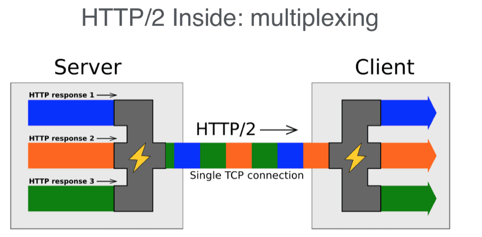

The key features of HTTP/2 are the same as SPDY:
  • HTTP/2 is a binary, rather than text, protocol, making it more compact and efficient
  • It uses a single, multiplexed connection per domain, rather than multiple connections carrying one file each
  • Headers are compressed with the purpose‑built HPACK protocol (rather than gzip, as in SPDY)
  • HTTP/2 has a complex prioritization scheme to help browsers request the most‑needed files first, which is fully supported in NGINX (SPDY had a simpler scheme)

  1. Uses a single connection per server – HTTP/2 uses one connection per server, instead of one connection per file request. This means much less need for time‑consuming connection setup, which is especially beneficial with TLS, because TLS connections are particularly time‑consuming to create.
  2. Delivers faster TLS performance – HTTP/2 only needs one expensive TLS handshake, and multiplexing gets the most out of the single connection. HTTP/2 also compresses header data, and avoiding HTTP/1.x performance optimizations such as file concatenation lets caching work more efficiently.
