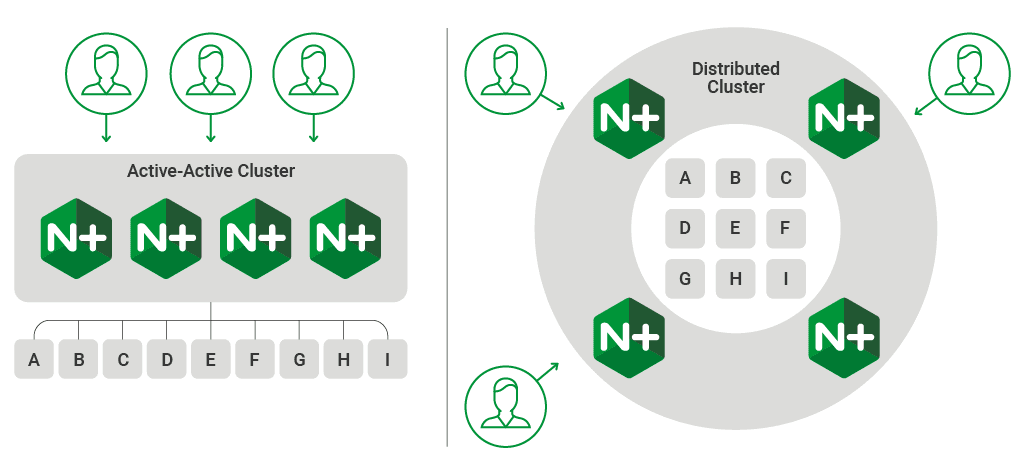

Classic load‑balancing methods such as Least Connections work very well when you operate a single active load balancer which maintains a complete view of the state of the load‑balanced nodes. The “power of two choices” approach is not as effective on a single load balancer, but it deftly avoids the bad‑case “herd behavior” that can occur when you scale out to a number of independent load balancers.
This scenario is not just observed when you scale out in high‑performance environments; it’s also observed in containerized environments where multiple proxies each load balance traffic to the same set of service instances.
Cluster topologies using distributed load balancers
A common instance of this scenario occurs when you use NGINX Ingress Controller for Kubernetes, with one load‑balancing instance per Kubernetes node.

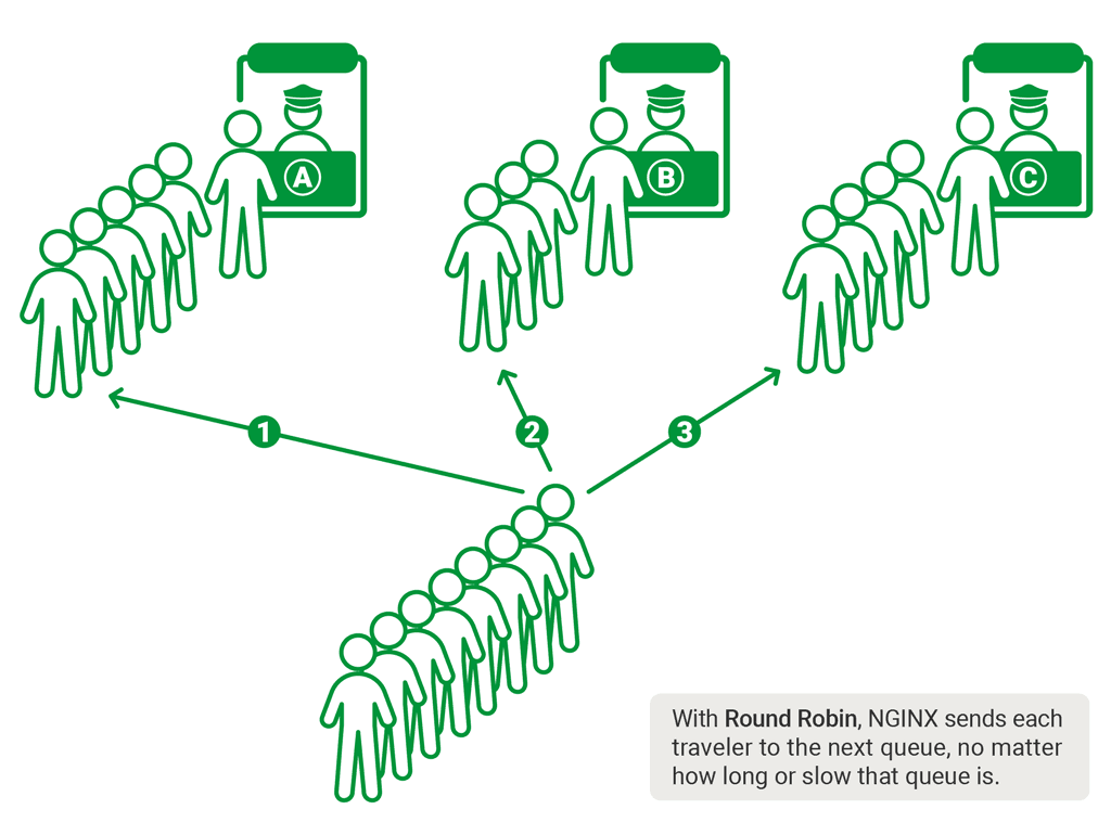

Round-Robin Load Balancing
Round robin is a naive approach to load balancing. In this approach, the guide selects each queue in rotation – the first traveler is directed to queue A, next traveler to queue B, and so on. Once a traveler is directed to the last queue, the process repeats from queue A. Round Robin is the default load‑balancing algorithm used by NGINX:
This approach works adequately, until there’s a delay in one of the queues. Perhaps one traveler has misplaced his or her documentation, or arouses suspicion in the immigration officer:
The queue stops moving, yet the guide continues to assign travelers to that queue. The backlog gets longer and longer – that’s not going to make the impatient travelers any happier!

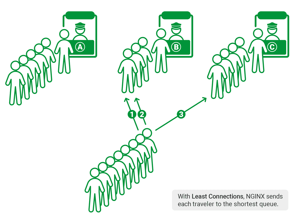

Least Connections Load Balancing
There’s a much better approach. The guide watches each queue, and each time a traveler arrives, he sends that traveler to the shortest queue. This method is analogous to the Least Connections load‑balancing method in NGINX, which assigns each new request to the server with the fewest outstanding (queued) requests:
Least Connections load balancing deals quite effectively with travelers who take different amounts of time to process. It seeks to balance the lengths of the queues, and avoids adding more requests to a queue that has stalled.

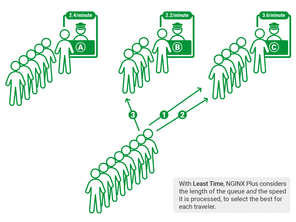

Least Time Load Balancing
We’ve seen that different passengers take different times to process; in addition, some queues are processed faster or slower than others. For example, one immigration officer might have computer problems which means he processes travelers more slowly; another officer might be a stickler for detail, quizzing travelers very closely. Other officers might be very experienced and able to process travelers more quickly.
What if each immigration booth has a counter above it, indicating how many travelers have been processed in, for example, the last 10 minutes? Then the guide can direct travelers to a queue based on its length and how quickly it is being processed. That’s a more effective way to distribute load, and it’s what the Least Time load‑balancing algorithm in NGINX Plus does:
This algorithm is specific to NGINX Plus because it relies on additional data collected with NGINX Plus’s Extended Status metrics. It’s particularly effective in cloud or virtual environments where the latency to each server can vary unpredictably, so queue length alone is not sufficient to estimate the delay.
