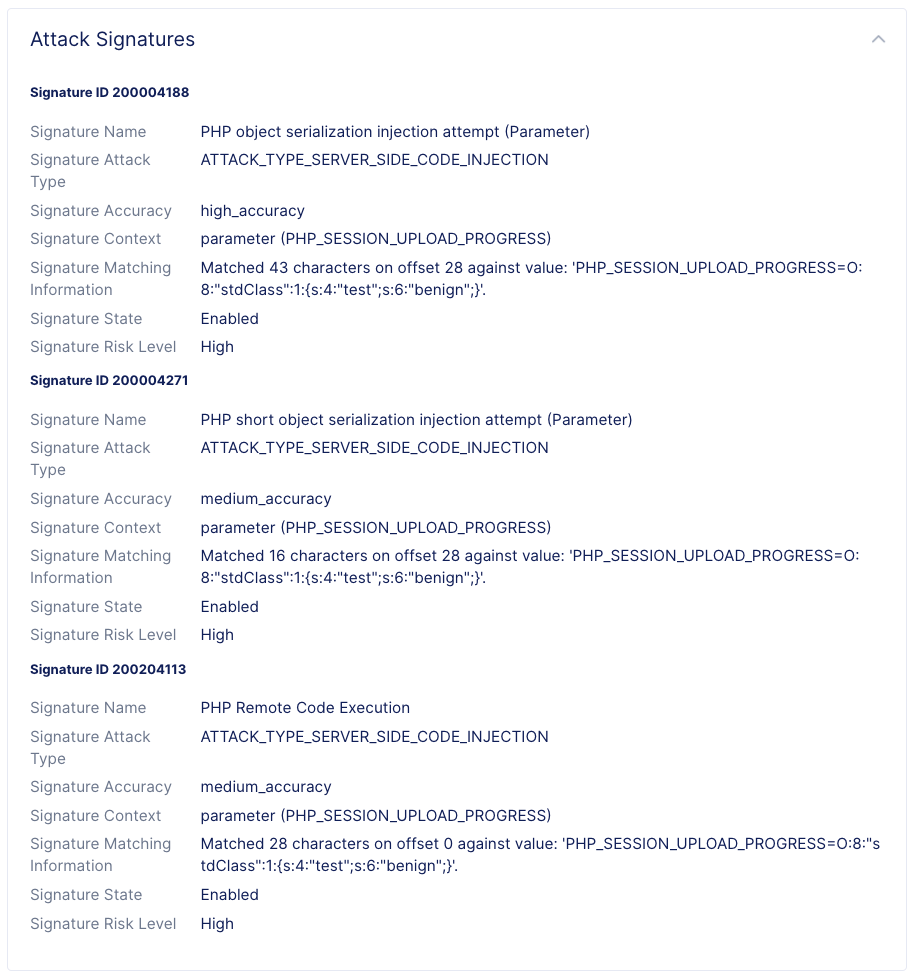

Here’s what one of those blocked requests looked like inside F5 WAF for Distributed Cloud:
In F5 testing, existing F5 WAF for Distributed Cloud signatures for PHP object serialization injection flagged a PHP2Shell-style request in PHP’s session upload-progress field, before any PHP2Shell-specific signature existed.

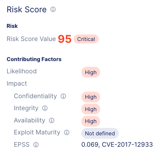

AI-powered WAF changes that. At its core is a neural network, a type of machine learning model, trained on real attack data from F5’s global security operations. Because it learns from attack patterns instead of waiting for a new rule, it can recognize a fresh exploit that behaves like attacks it has seen before. For each suspicious request, it weighs the parts that look malicious against what it has learned, decides whether the content is truly harmful, and returns one risk verdict that the WAF acts on immediately.
AI-powered WAF rated a PHP2Shell attack request 95 out of 100, critical risk, based on what it had already learned from past attacks. Best practice: configure for the outcome you want.
For PHP2Shell, that verdict was 95 out of 100. The malicious requests were blocked on the spot, and legitimate traffic kept flowing.
