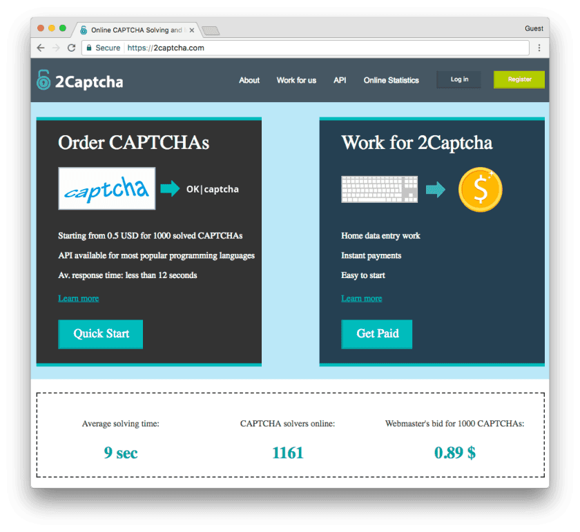

Upon accessing the site 2Captcha.com, the viewer is greeted with the image below, asking whether the visitor wants to 1) work for 2Captcha or 2) purchase 2Captcha as a service.
Option 1 – Work for 2Captcha
To work for 2Captcha, simply register for an account, providing an email address and PayPal account for payment deposits. During a test, an account was validated within minutes.

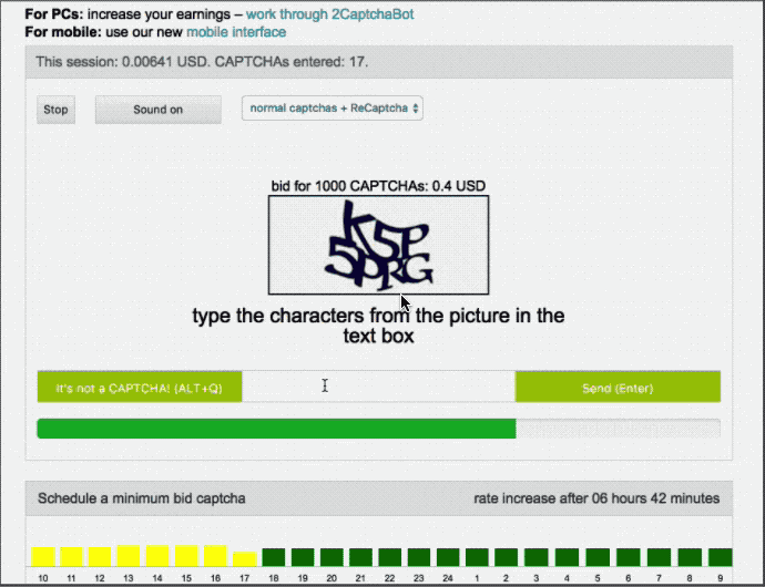

New workers must take a one-time training course that teaches them how to quickly solve CAPTCHAs. It also provides tips such as when case does and doesn’t matter. After completing the training with sufficient accuracy, the worker can start earning money.

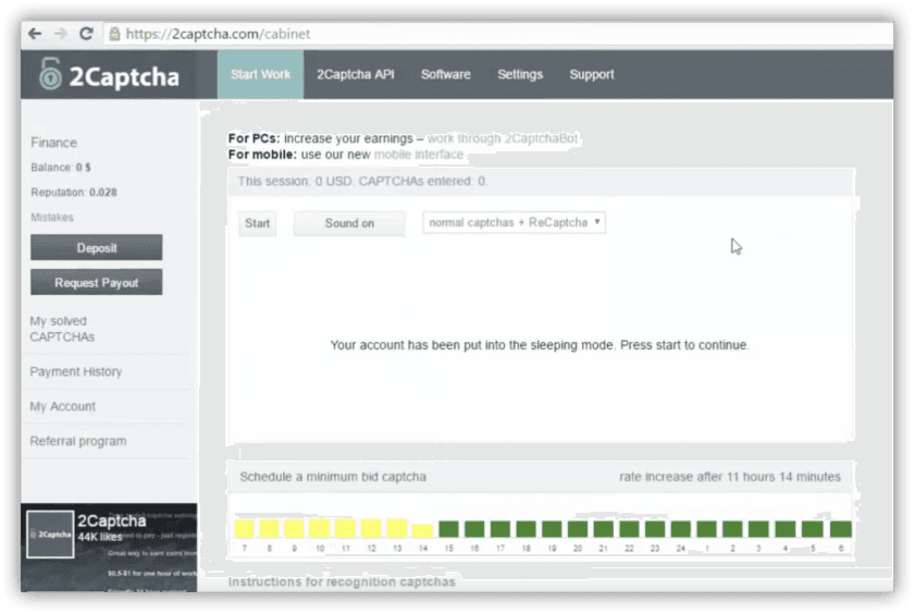

After selecting “Start Work,” the worker is taken to the workspace screen, which is depicted above. The worker is then provided a CAPTCHA and prompted to submit a solution. Once solved correctly, money is deposited into an electronic “purse,” and the worker can request payout whenever they choose. There is seemingly no end to the number of CAPTCHAs that appear in the workspace, indicating a steady demand for the service.
2Captcha workers are incentivized to submit correct solutions much like an Uber driver is incentivized to provide excellent service—customer ratings. 2Captcha customers rate the accuracy of the CAPTCHA solutions they received. If a 2Captcha worker’s rating falls below a certain threshold, she will be kicked off the platform. Conversely, workers with the highest ratings will be rewarded during times of low demand by receiving priority in CAPTCHA distribution.

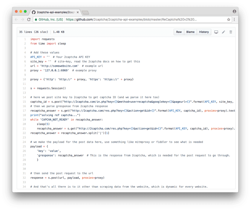

2Captcha helpfully provides example scripts to generate API calls in different programming languages, including C#, JavaScript, PHP, Python, and more. The example code written in Python has been reproduced below:

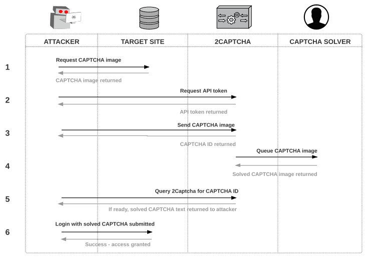

How would an attacker use 2Captcha in a credential stuffing attack? The diagram below shows how the different entities interact in a CAPTCHA bypass process:
Technical Process:
- Attacker requests the CAPTCHA iframe source and URL used to embed the CAPTCHA image from the target site and saves it locally
- Attacker requests API token from 2Captcha website
- Attacker sends the CAPTCHA to the 2Captcha service using HTTP POST and receives a Captcha ID, which is a numerical ID attributed with the CAPTCHA image that was submitted to 2Captcha. The ID is used in step 5 for an API GET request to 2Captcha to retrieve the solved CAPTCHA.
- 2Captcha assigns the CAPTCHA to a worker who then solves it and submits the solution to 2Captcha.
- Attacker programs script to ping 2Captcha using CAPTCHA ID (every 5 seconds until solved). 2Captcha then sends the solved CAPTCHA. If the solution is still being solved, the attacker receives a post from 2Captcha indicating “CAPTCHA_NOT_READY” and the program tries again 5 seconds later.
- Attacker sends a login request to the target site with the fields filled out (i.e. a set of credentials from a stolen list) along with the CAPTCHA solution.
- Attacker iterates over this process with each CAPTCHA image.
Combined with web testing frameworks like Selenium or PhantomJS, an attacker can appear to interact with the target website in a human-like fashion, effectively bypassing many existing security measures to launch a credential stuffing attack.
